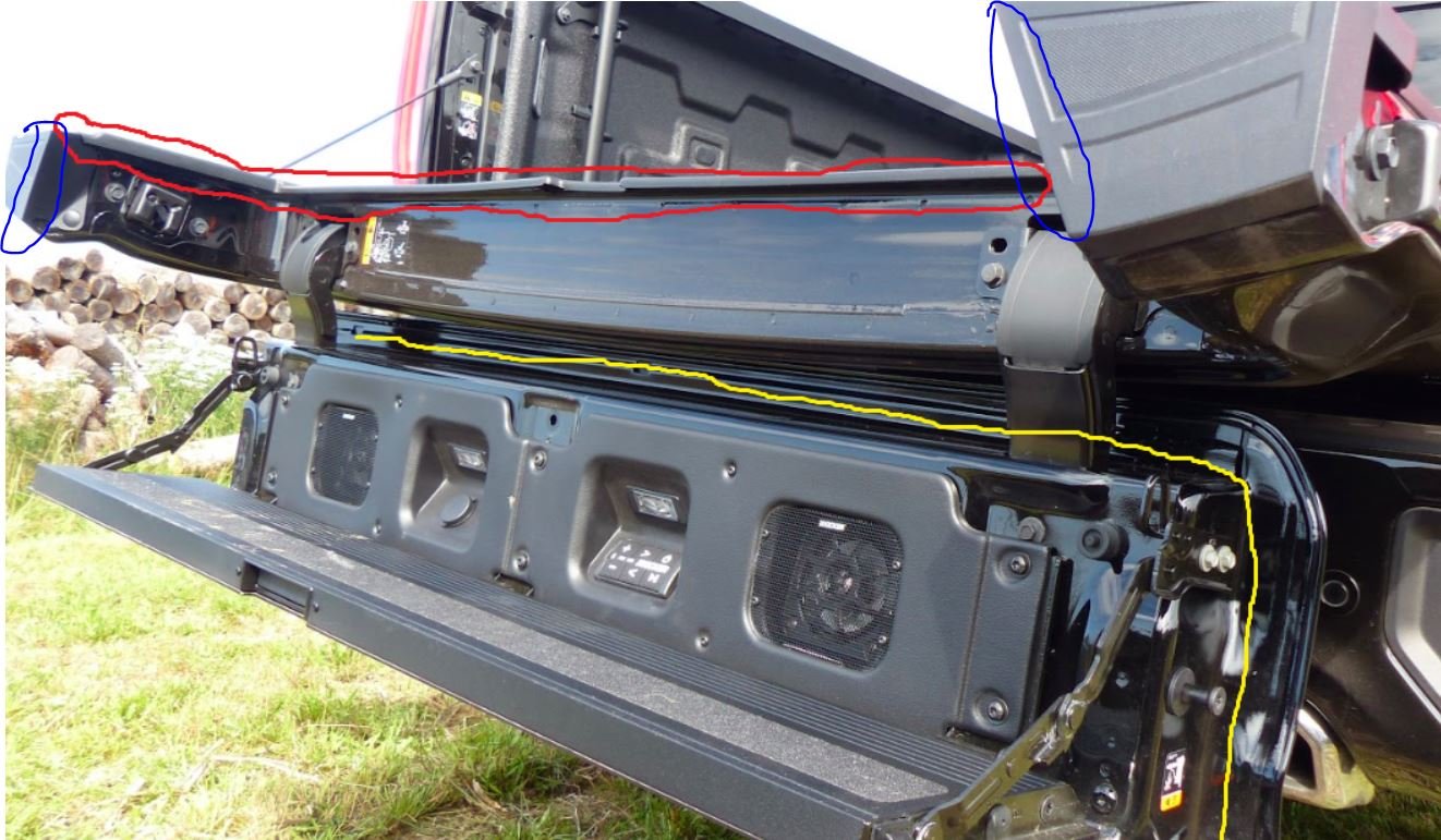

I own a 2019 GMC SLT Sierra with a multi-pro tailgate.  The opening between the main tailgate and the interior tailgate allows water, dirt and snow to come through the 3/4 inch crack between the main and interior tailgate.  The very top lip of the tailgate between the two tailgates has a huge opening which continues to the bottom of the interior tailgate.  GM failed install weather stripping or a seal in this area, so water, dirt and snow will seep through easily through the large crack.  I have a Lomar Tonneau cover and when I went through a car wash yesterday, my interior box bed was wet about 2 ft in from the exterior bed.  If you place a flashlight inside your truck bed and have a Tonneau cover you will see why this crack between the two tailgates allows so much water into the truck bed.  If you view the photos attached, I have circled in red the area that a weather stripping seal is needed.  My GM dealership told me, if I wanted a dryer truck bed, I should have ordered a Yukon.  All owners of a 2019 or 2020 GM with a multi-pro tailgate need to express our disappointment with this design and demand that GM fix the design flaw.

I have the Retrax ProXR and have been working on getting it as waterproof as possible.  Most of the water I have is coming in through that gap between the 2 sections of the tailgate.  I picked up this weatherstripping from Lowes and put some at the very top on the plastic cap between the 2 tailgates.  That stopped a large amount of the water coming back there.  I think I still have some coming in between the larger gate and the bed on the sides - still working on that piece.  I also have a Rok Block tailgate seal, but haven't installed yet - waiting to get the water coming in from the top addressed before I seal up the main exit path for it.
https://www.lowes.com/pd/M-D-13-ft-x-1-in-Expand-N-Seal-Foam-Window-Weatherstrip/1000460601
