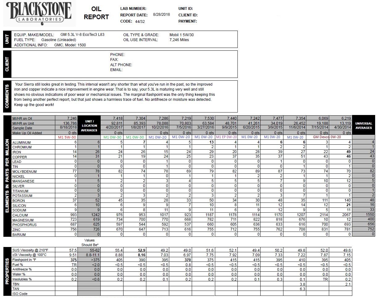

I have always followed the OLM down to around 5% or so. This is where you usually get the "change oil soon" message. Usually comes out to around 7,300 miles. I have primarily used Mobil 1 in 0W-20 AFE but also 0W-20 EP, 0W-30 AFE and standard 5W-30. I have had a few UOA's done from Blackstone and have never seen any issues.
That’s great, now try comparing this same amount of mileage using Amsoil Signature Series and then compare the two. Better yet, try running 10K miles on Amsoil Signature Series, then compare the two.
My recommendation is for EVERYONE to use what they can afford and what works best for them, don’t take my word for it. Mobil1 Annual Protection is an excellent oil, I just want the maximum protection available between my oci’s.
Sent from Above
