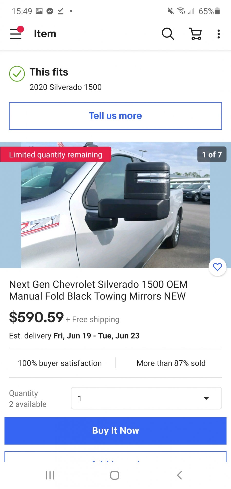

I have a 2020 LT trailboss does not have the HD camera or 360* view stuff. If i upgrade to tow mirrors it is plug n play to have them power adjust correct? Personally i dont care about the mirror lights. I mean this place offers a harness for $160 so that aint bad might just do it. But does anything need to be flashed? Or can i just plug my harness and tow mirror in and everything will work?
This is what im looking at. Figured buy these and sell my old ones. Especially since the camera sucks this will help

Correct. If you have a 2020 LT Trail Boss the power adjust and heat will work out of the box. Plug and play.

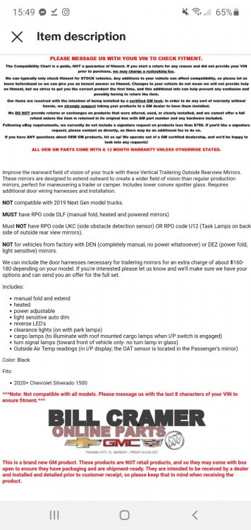

Do you think its worth paying the 160 for the harness? Is that gonna give me lights and everything? Will the dealer have to flash it?

You’re welcome. If the dealer is installing and flashing for $160 - yes that’s worth every penny. And yes - getting the harness makes the lights work.
If $160 is only the parts and no labor or flashing - then no. However doing it yourself is a good 6 hour wiring project. But on the plus side doing it yourself you don’t have to flash the BCM.

Yeah $160 was just for the harness off the website. Not sure how much itd be for the install/ flash.
I actually wouldnt mind doing the wiring myself. Do you have instruction on that? I couldn't find them online. I definitely got the time to do it.
