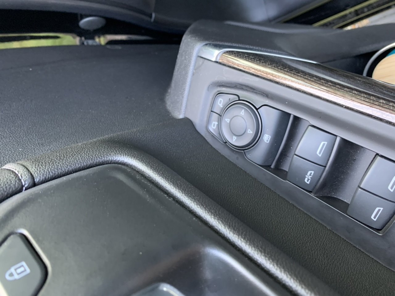

This is what my mirror buttons look like on my truck with standard mirrors. Do those with the factory tow mirrors have different buttons to adjust the top/lower mirrors? I do not have power folding or technology package. Just safety package with blind spot monitoring - which I’m ok with losing with tow mirror addition
The buttons look the same, except the large window lock button you have is split in two for me, with the split button on the right being for power folding, and the split button on the left being for window locks.
The lower convex mirror is manual adjust on all the mirrors, only difference is that the fancy mirrors have a power fold button.
