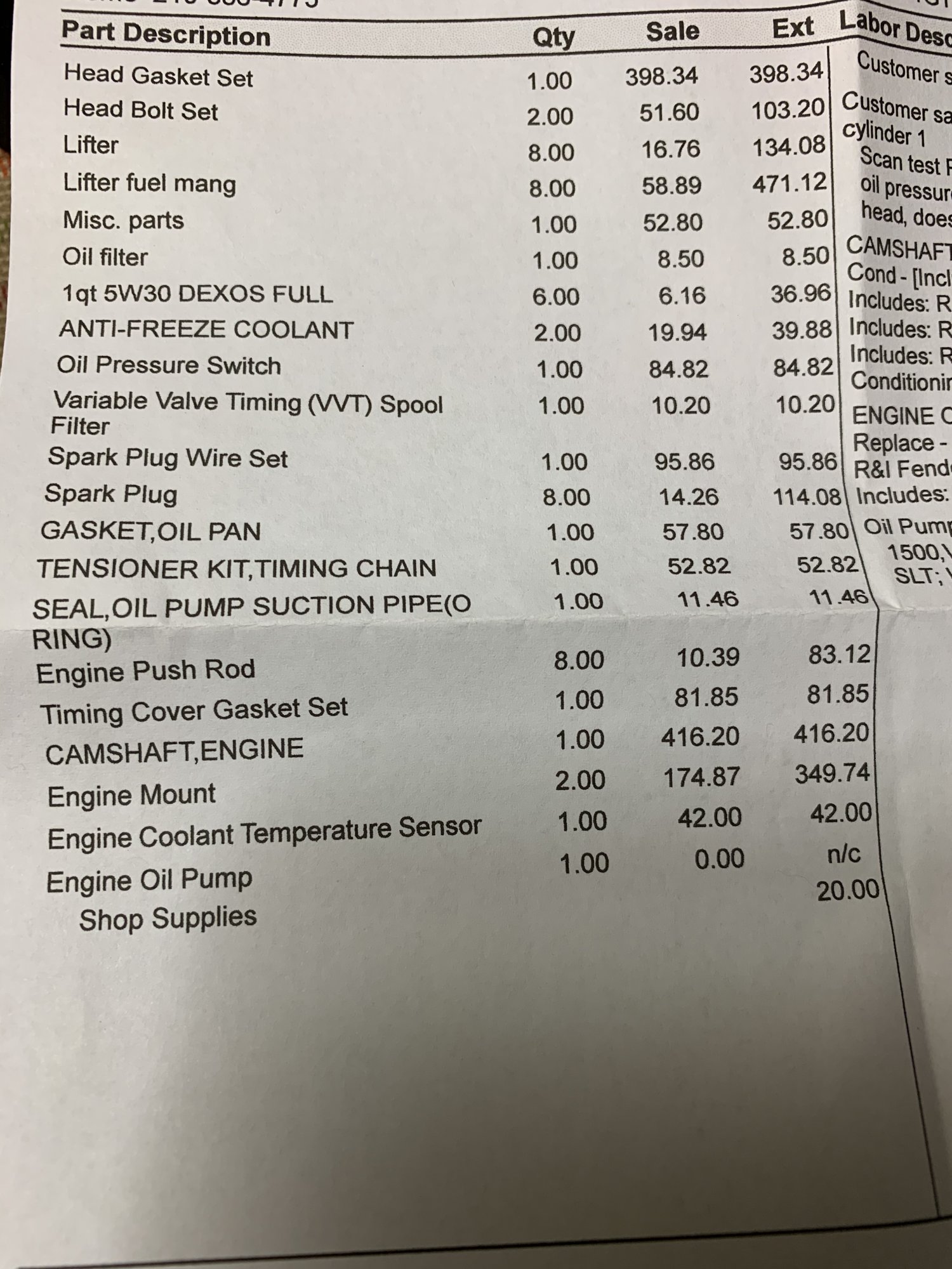

Just got my Sierra back from local garage. Below is the work they did ( had a lifter collapse on cylinder one)on my 2008 has 203,457 miles. My question is the owner of the shop( an old drag racer) said they put 20w50 when they did the oil change ( due to high miles ) that seems like way too heavy a weight? Am I right? Thanks, new to the forum.820DE564-654A-4D4A-A891-18C162947F79.thumb.jpeg.5c2b7130d432591b340c7dd986ffb1bd.jpeg
Yeah, it's a bit heavy.
That's the stuff oil classic cars run or engines with larger clearances.
Yes, that is not recommended.  It will run just not what the engine is designed for.  For your locations and the miles you could go to a 10w-30 year round.

Forget what an old worn engine in this condition should run on.....the question is what oil should 8 brand new AFM cylinder lifters that were installed should run on.....I suspect they'll function best on the original oil indicated on the filler cap
