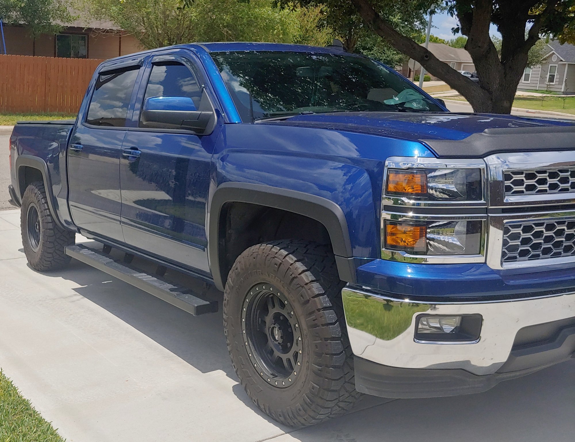

Looks good.  Any other angles?  I've been eyeing a set of fender flares like yours, I've been looking at the OE bushwacker flares.
1 hour ago, Car881 said:
Great looking truck! Did you just level the front or did you replace the blocks under the bed? What manufacturer did you go with?
Appreciate it! I just leveled the front, I have the 2 inch blocks for the back but haven't decided if I want to put them on or not. Right now it sits perfectly level but when I have something with a little weight in the bed it squats of course. It's rough country so it's the half inch plate on top of shock/ strut and 2 inch spacer on bottom of strut. No rubbing only very, very little at full lock.
Appreciate it! I just leveled the front, I have the 2 inch blocks for the back but haven't decided if I want to put them on or not. Right now it sits perfectly level but when I have something with a little weight in the bed it squats of course. It's rough country so it's the half inch plate on top of shock/ strut and 2 inch spacer on bottom of strut. No rubbing only very, very little at full lock. Trying to submit more photos but says max total file size is 4.8 mb ?
Thanks! I'm trying to submit more photos but says the file size is too big? Says max available is 4.8 mb? I got the Duratek OE flares from AmericanTrucks.com .
Try emailing the pics to yourself, you can adjust the size that way.  Are there any gaps in the flares against the fender?

There was a small gap on only one of the rear ones, like it was a little warped but I guess with the heat it molded to the truck so there's no gap now.
