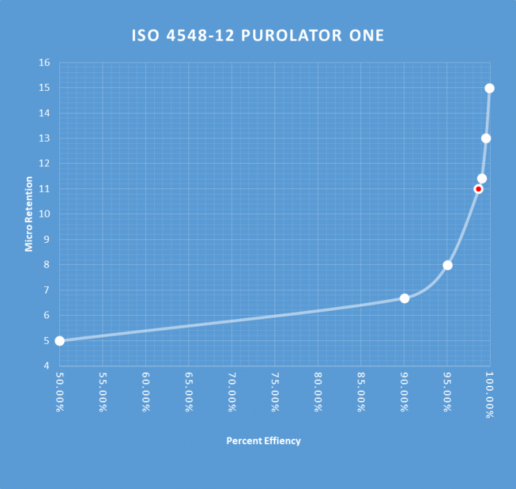

Purolator PL22500 is better than the lot of them. FRAM ULTRA GUARD is also on par.
