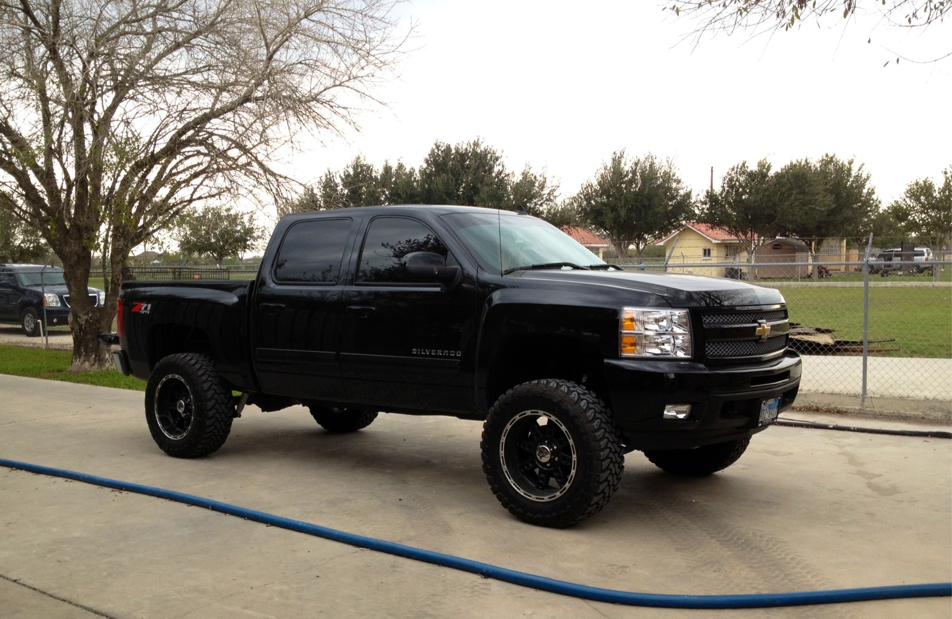

Newbie 2010 Z71 6"BDS 35's (Headers? Tune? Regear?)

Update: Paid deposit for 4.10 gears installed by 4WheelParts on Monday next week, and a custom tune by Nelson in San Antonio shortly afterward..
Fear the gear a little, but excited none the less
Just got my truck back with 4.10's.. I feel a small difference in power and my speedo is off about 10mph at 70 (reads 80 actually 70) and about 5mph at lower speeds. I confirmed this with a friend driving next to me.
I'm not totally blown away yet but......
The shop said a tune will fix everything and "loosen" up my truck...
I'm doing that next at Nelson in San Antonio.. Hopefully along with some headers... I'll keep y'all posted.
Thanks for all your input.
Yes sir you're absolutely right.. At actual 70 I'm running at about 1900 rpm and it downshifts a lot less...
At slower speed (in town) it looks like I'll actually save some gas. Im sure I'll be happy once I tune it..

Update: Tuned by Nelson (San Antonio) Great service..Tuned for better drivability.
Best thing Ive done so far...! Totally different truck now.. That along W the 4.10's huge difference.. Truck feels lighter and waaaay more responsive. Firmer shift points growing on me too..
For sure will save some gas in the city but will most likely stay at 14mpg on the hwy going 70.
