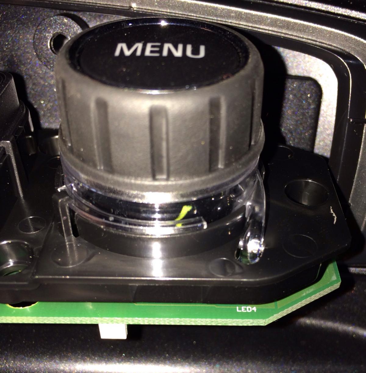

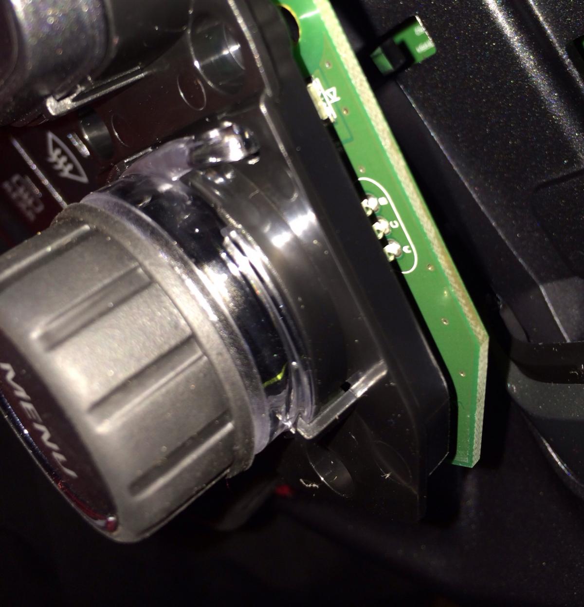

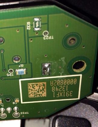

For those of you who have the silverado and are missing the glowing rings around the knobs (everyone) I have good news for you! Below you will see pictures that the lights are installed and the rings that glow are installed. However, for one reason or the other they are not turning on. I'm going to check if I'm missing a fuse or even better, take it to the dealership and tell them to figure it out. Everything needed is there. You can see that next to R32 the LED is connected to the board.
The LED's are just soldered to the board. there should be jumpers , diodes, resisters or "something" in those empty holes providing power to the LED's.. My question is how did you get that out of there.. i tried lightly prying on the plastic trim, but didnt want to break it...

So you take the entire center dash off. The screen, radio and air control all come off as one piece. Behind it you will find about 10 screws. Take them off and then the plastic that covers the screen and radio knobs. You will then see 5 more screws that hold the radio controls ( knobs and buttons ). Taking those of will allow the price to come free and then gently pry the plastic cover away from the knobs and buttons and you will see everything. Keep in mind that while doing this you will have 3 ribbons that connect everything together. Be careful not to rip or damage these at all. You will be sorry doing so. Hope that helps, also... Everything to light up the LED's is there, from what I saw the LEDs that do light up follow the same track as the ones that don't.

So the LED thing is a software issue... like so many other issues with this truck.
What about insisting they swap it out with a board from a Sierra?
