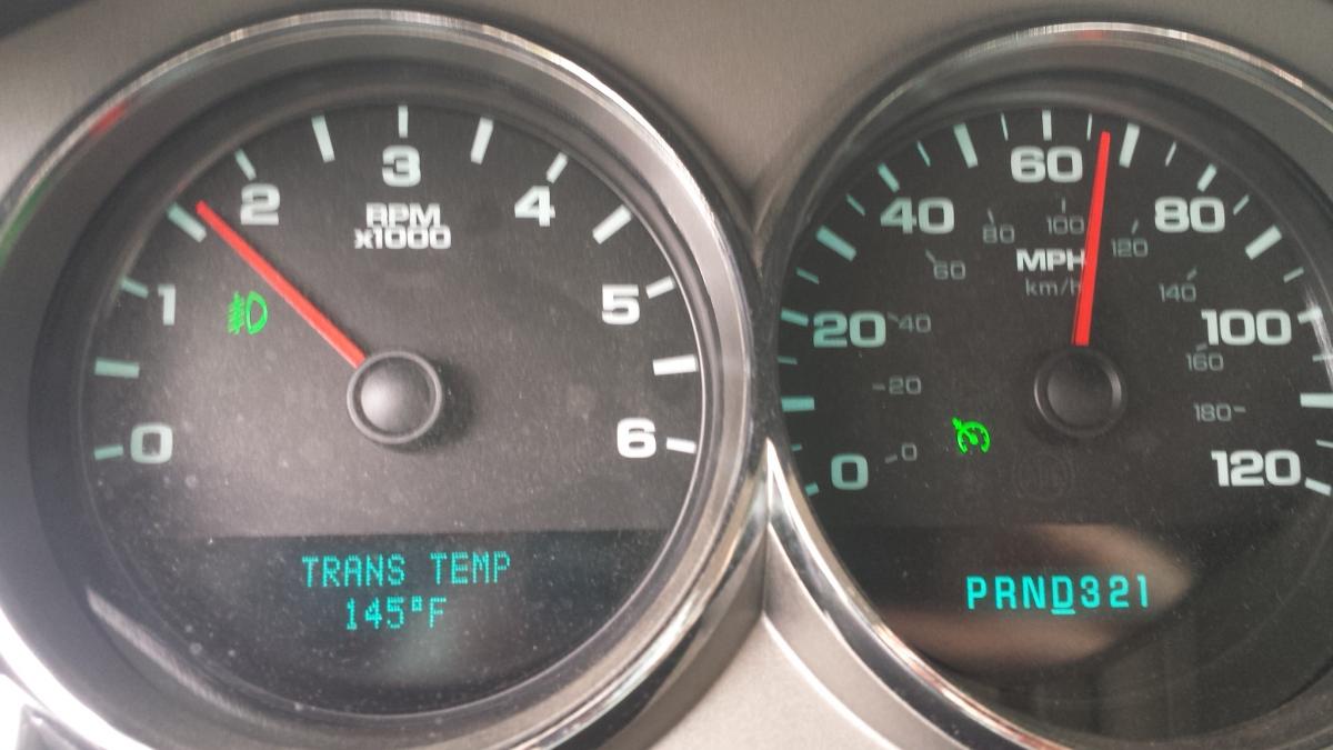

Been driving for almost 5 hours and current outside temp is 85. Screen shot below.
