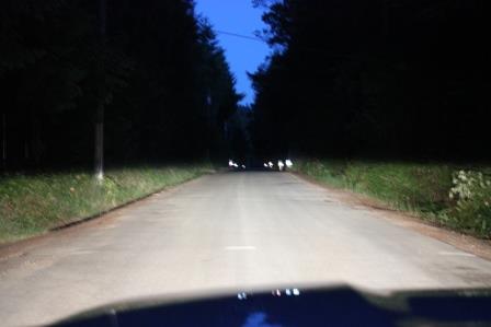

I took my truck in this week for the new headlights and BCM flash. It is a significant improvement over the original headlights. A new bulletin has recently been issue (do not have the number), but it is PIT5374B. I appreciate the wealth of knowledge because my dealership did not have a clue.
Pictures attached of before and after. The biggest benefit was in the light output and color (whiter beam). The top two pictures are high beam and the lower two are low beam.
