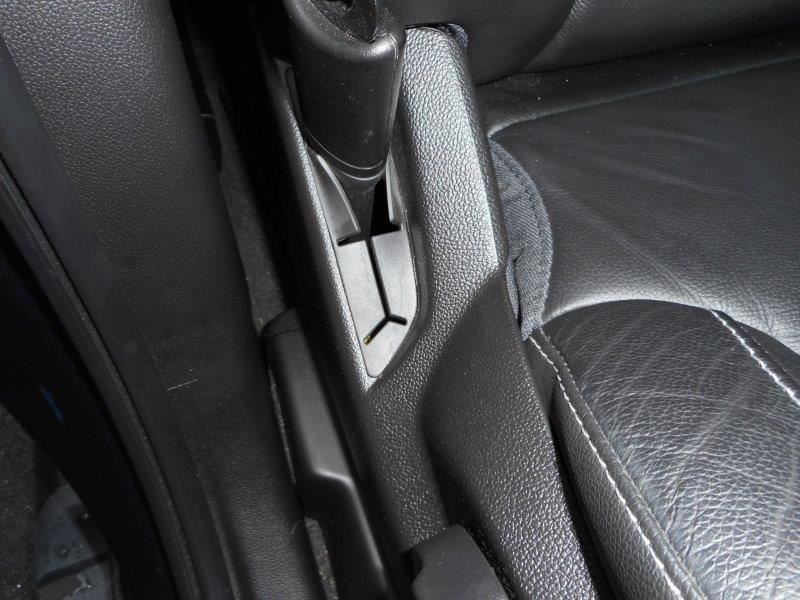

I test drove a 2016 Silverado the other day and the flaps were not chopped or factory cut out. Today I was in a 2017 Tahoe and it had the factory cut out. The attached picture is in the Tahoe. I don't have a picture of the truck, but I made sure that it wasn't chopped. I haven't done it to my truck and probably won't if I decide to upgrade. [emoji6]

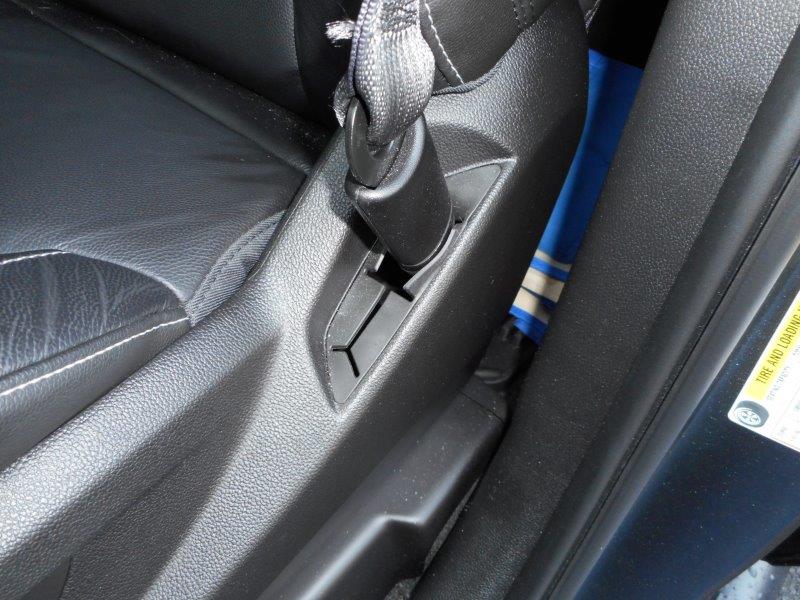

This is what mine looks like when I had them order the new part (side of seat) directly from factory and wait for it, it was not an off the shelf part.
Likely the difference is the 2016 was built in 2015 before said change and the 2017 was built after. This issue did not exist before June 2016 so anything built before would look as you seen. Anything after looks like the pic.
At this time the recall does not cover any 2016 even if they look like the one you seen. Chalk it up to legal mumbo jumbo and no reported issue or NHTSA filing for that year. Does not mean there will not be or may not.
Huge shout out to Alpine Truck Life, who's prior work allowed me to get my crap job resolved quickly. See his post # 178 & 189. The replacement part is: 84147954 - cover asm f/seat.
I have the brand new one now. I may try to replace it myself, otherwise they will do it for me when I return for next oil change.
