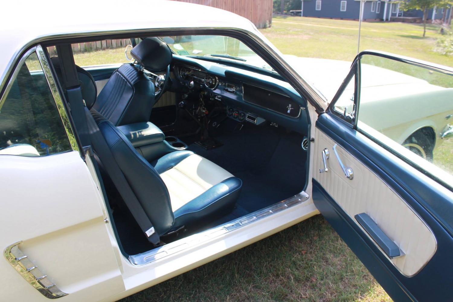

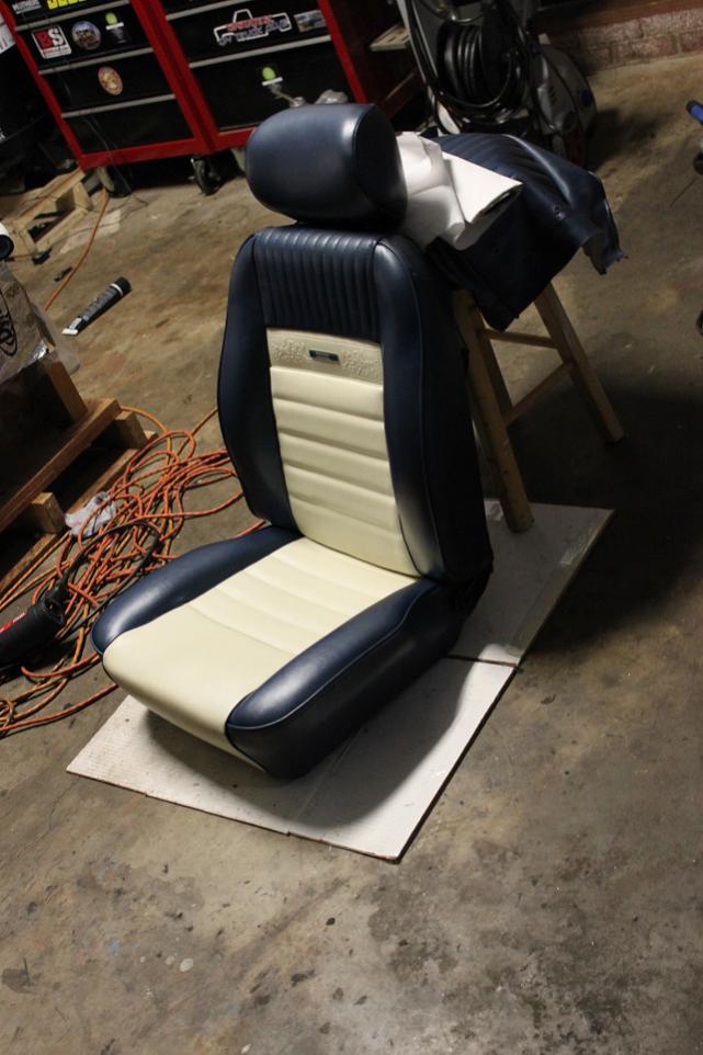

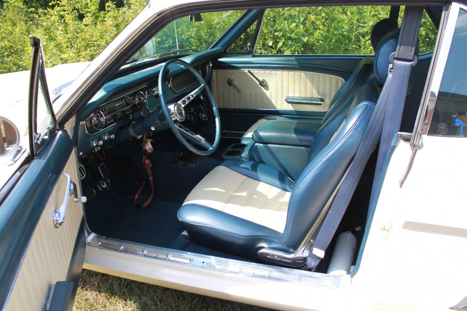

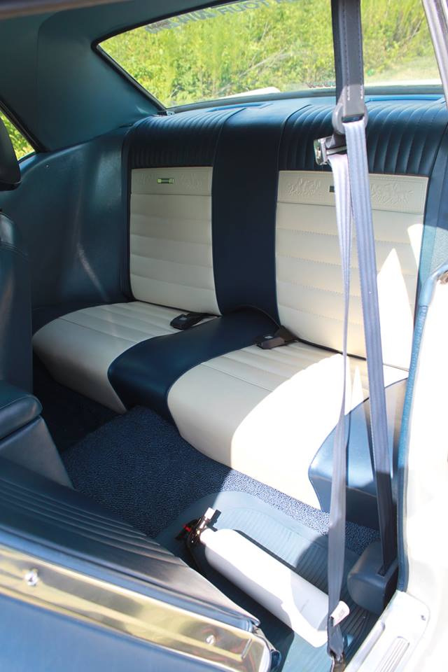

​Want to try something difficult? Hog ring a TMI sport seat kit into your 65 Mustang. This was my first interior job I've ever tried. I then recovered the bench in my 67 C10 and now the Z71.
THAT looks custom...bitchen color scheme.
It is. Ford never offered a dark blue/white pony interior, only medium blue and white (for blue). They sent me some 65/66 Color samples and I picked the ones that matched the best. TMI also made the two tone door panels to match.
