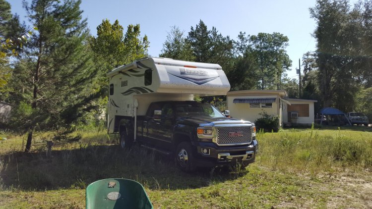

I have a 2017 GMC Denali HD with the 6.0 Liter gas motor.  I can't seem to find a performance tuner that fits this year.  Anyone out there find one and if so how is it?  I'm looking to tune for gas mileage, I haul a truck camper and get terrible gas mileage, could be my lead foot too LOL

Unfotunately your carrying a big heavy sail around. Your mileage is going to take a hit regardless of what you do.
It's not even the weight, it's the sail part that hurts the most. When I had a slide in, it would drop my diesel (2004.5 Dodge 2500 Cummins, NV5600 6spd manual, 4.10 rears) from a trip average of 21mpg to a trip average of 14.5mpg, and that one only weighed a little more than 1k pounds.
