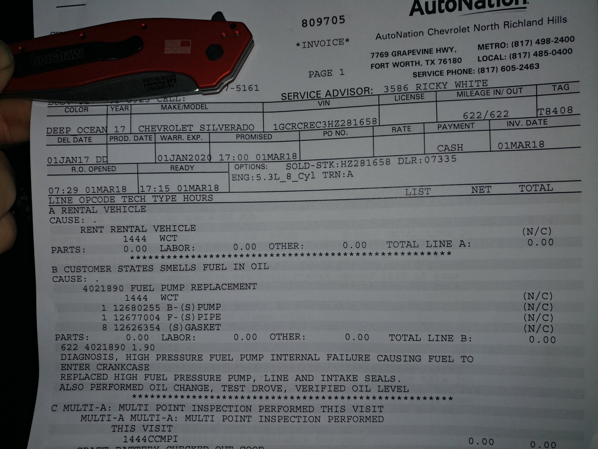

Ok, just an update on my truck.  I dropped it off this morning and picked it up an hour ago.  They replaced the HPFP, and changed the oil. I guess only time will tell.  I checked the dipstick and took pictures of it this time.  Yea I might be a little picky but its a brand new damn truck, I want it to last.  I will update if anything changes.

The truck has about 1200 miles since the last oil change.  Went by the dealer today and both they and I believe the problem has been fixed with the replacement of the HPFP. The smell of gas is very faint and the oil level seems to be holding steady.  So at the risk of jinxing myself I'm calling this issue fixed.
KD5FPV, I actually got to speak to the tech who worked on my truck.  He told me it was an internal diaphragm in the HPFP that failed.  My work invoice wasn't that clear, or as clear as yours (as read above), but yours mentioned an internal failure and what he told me matches your invoice.  Makes me wonder if it was a bad batch of fuel pumps.  My truck was delivered in January 2017.
Hope this thread proves helpful for anyone who runs into this problem themselves.

Isn't the HPFP in the tank ?  How does this affect the oil level maybe I am missing something here ?
Ok I guess super high pressure caused the seals to leak , I would think a code would be thrown because there are sensors for lost pressure but  not for higher pressure? , all these things keep me up at night !!!!
