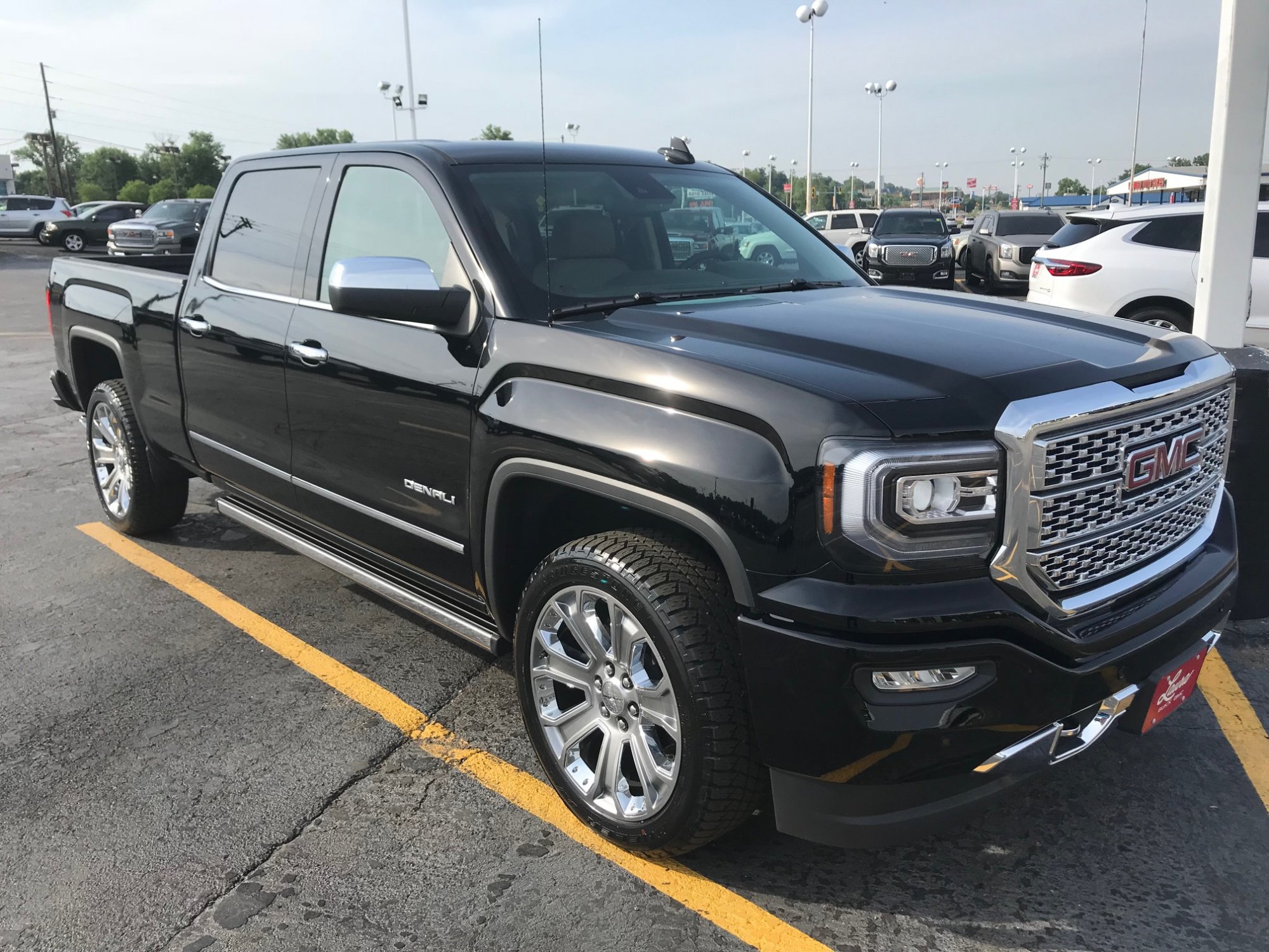

OK I got my Blue truck FIXED  today at Laura GMC. (Traded it in)   To me a large amount of gasoline in the oil crankcase pretty much guarantees a shortened engine life span. Laura had an unbelievable deal on Denali's almost 18k off MSRP they were of course pretty low on my tradein value but to me it was worth a few thousand to get a brand new truck and hopefully (fingers crossed knock on wood etc) this one will not have any serious issues. I put 300 miles on it driving back today and man it drives good plus it is really purty.... I am going to keep the dysonlabs sample bottle and just for grins and giggles have them do an analysis on this new engine at first oil change.  Oh I almost forgot I had them install a GM Borla Dual exhaust on this new one, I really missed that sound when I had it on my 2016 Denali. Dash trim looks flat on this one right now LOL.
Beautiful looking truck, and I've got to hand it to you for your brand loyalty, most of us would have jumped ship with what you've gone through.
