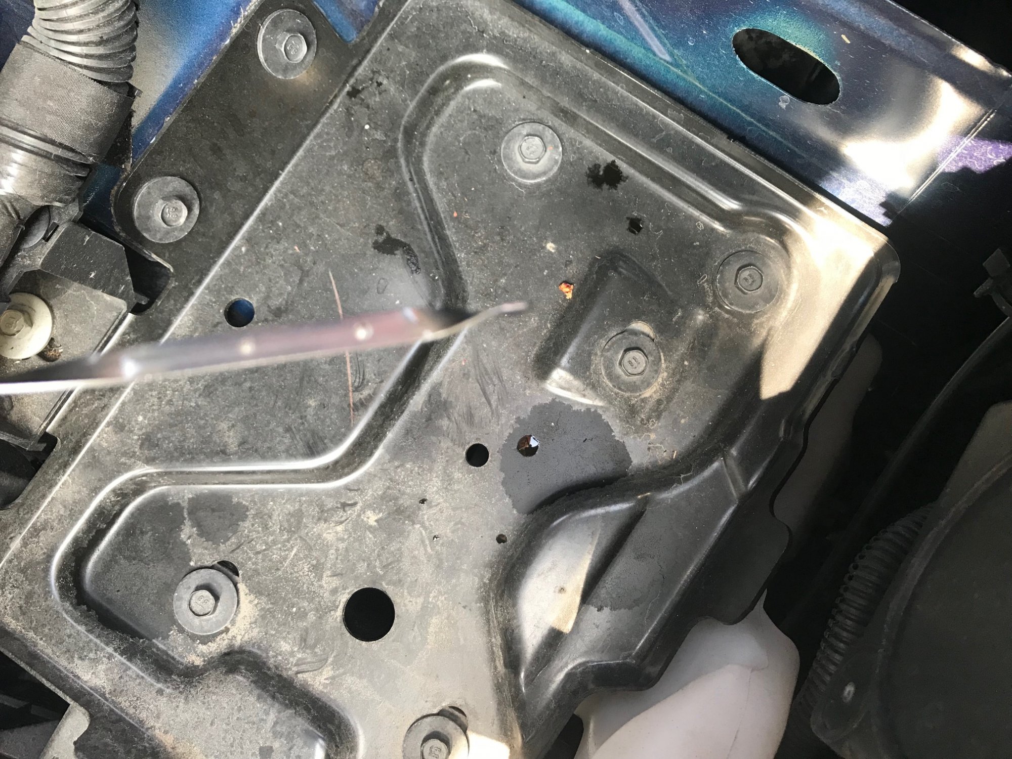

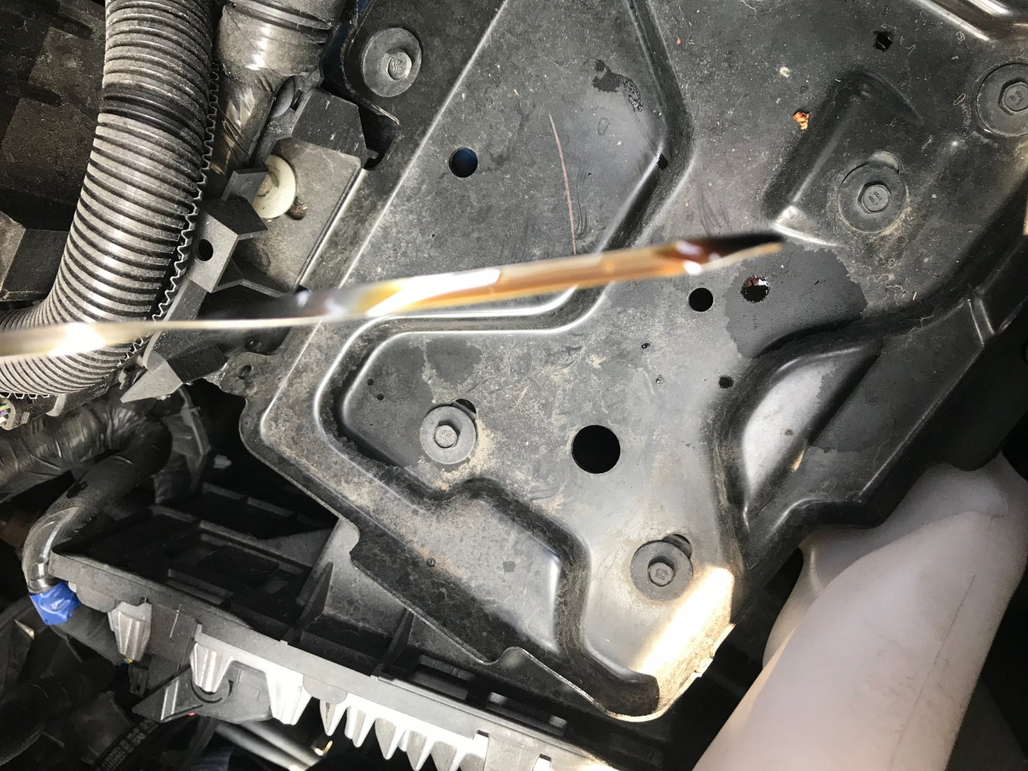

Oil level is rising it is now about 1/2" above top notch on the dip stick and I do have a gasoline smell. I will drop by my local dealership next week and see what they say.
I wish my dipstick was shiny like that
Mines a dark almost black metal finish which makes it hard to even see the oil level.
Just had my first oil change and I noticed the oil level is well above hash marks.  Maybe 1/2 inch or so.  No gas smell just an observation.

This $64,350.00 MSRP Truck has 15,000 miles on it. I dropped it off at dealership this morning and they called and said that they have ordered a replacement HPFP because it was leaking gas into the crankcase. They did not want me to drive it so I left it there for repair and got a loaner car. 17's only have a 60,000 mile factory powertrain warranty!  I think that any vehicle that has this "engine damaging"  issue should automatically be assigned a GM extended warranty on the engine to at least 100k miles!  I am convinced that the longevity of the internal parts bearing/piston rings/cam bearings lobes etc have been negatively affected, I just do not know to what extent.
It is a PITA to reach the oil dipstick but I will check it at every fuel up from here forward. Plus on my next oil change an oil sample will be sent to a lab for analysis. (maybe blackstone labs, that dyson analysis guy is really expensive lol)  IMG_5060.thumb.jpg.0706691f0fbd5f723f5c1486dfb9a616.jpg

I know the oil level was good a few weeks back when I checked it (maybe 3 to 4 weeks ago)  It was raining cats and dogs Tuesday when I picked it up from the dealership and then it was too dark yesterday afternoon when I got home from work to check the oil level. I just checked it a few minutes ago and it is about 1/2' above the full level on the oilstick. However since I did not check it at the dealership I am not 100% sure that they did not "overfill" it when they changed the oil? Still smells strongly of gasoline but that could be residual? I am not taking any chances,. I set an appointment to go back in tomorrow morning and have them check it. Maybe they can drain a bit out and I can keep an eye on it for a few days, or maybe there is another issue that needs to be resolved....................... I am waiting on a call from GM corporate to discuss with them about providing free oil changes and oil analysis up to 60k miles and a free extended warranty up to 100k. Silly engine could be chewing itself up inside and there is no way to know without oil analysis or a total engine tear-down.
Remember that GDI engines WILL normally get fuel past the rings and into the crankcase. Just because you can smell gas on the oil cap and on the dipstick does not mean you have a problem. A rising oil level however does indicate a problem. Make sure to be consistent on when you check it too; fully warmed up like after at least 15-25 miles and always level.
