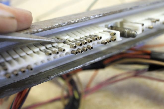

Did you try cleaning the electrical connections to the ECM? There are between 50 and 200 individual electrical connections, and if any one of them is corroded, the ECM may not work properly. You can clean them with electrical contact cleaner, and a soft bristled brush. Then apply some dialectic grease, and test it out.
