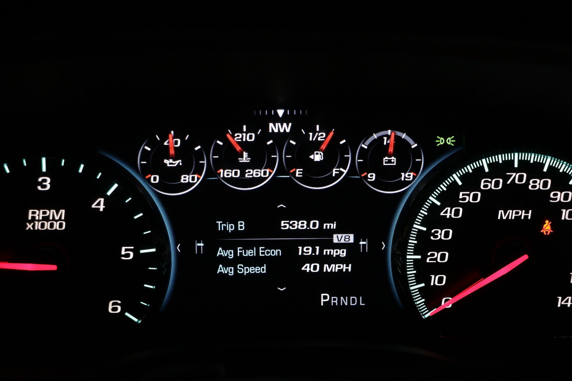

Is your AFM working?  Are you running Full synthetic oil?  What rear gear are you running?  My 2016 Silverado 5.3L  with 8 speed and 3:42 gear averaged 20.7 mpg over 84,000 miles and typically got 22 mpg on the Highway.  My 2019 5.3L Silverado, with 8 speed and 3:23 gears is doing even better!  This is my current tank of fuel:

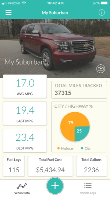

'16 Suburban with 44k and the lifetime fuel efficiency shown on the iPhone app is 16.3. I reset the trip computer every fill-up and I've seen the average for the tank as low as 12 and high as 19.
