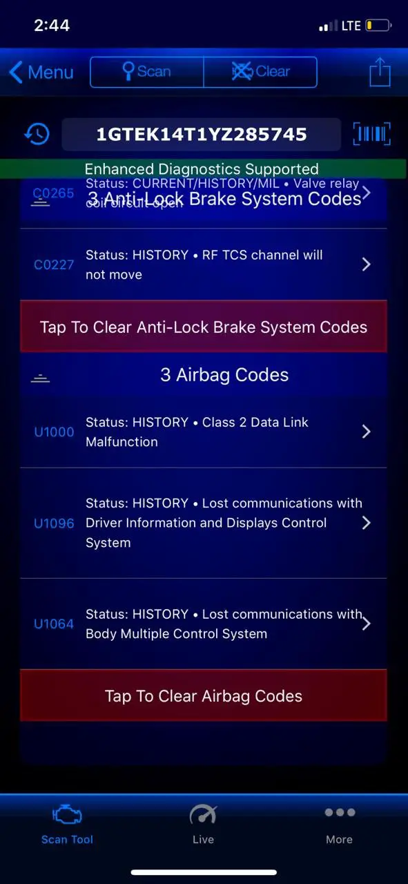

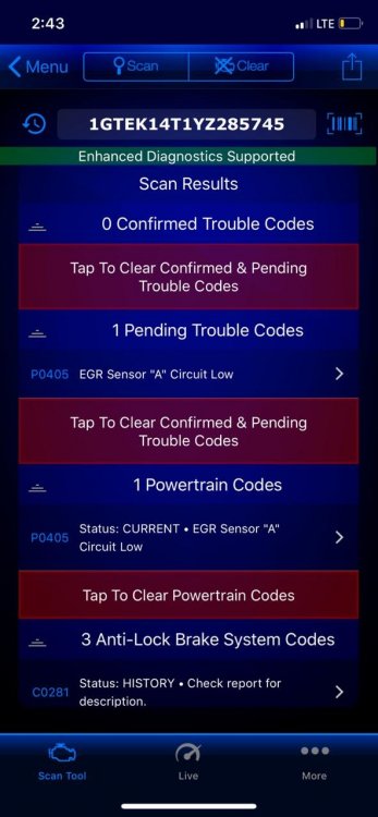

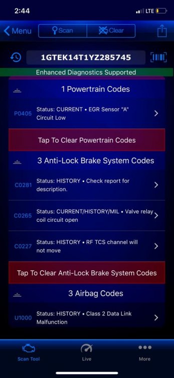

I will get the codes today and update you.

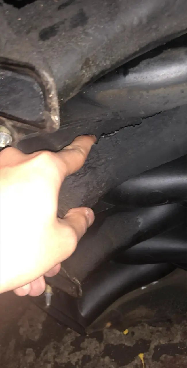

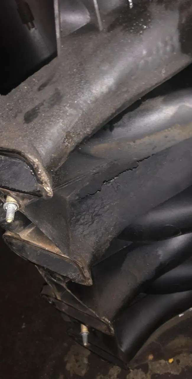

FINALLY after two months, i found the issue. There was BIG hole in my intake manifold causing the air to go right through. I changed the intake manifold with a new set of injectors and the car now runs perfectly. I hope this post helps anyone having the same issue i had. Here is a video and some pictures of the intake manifold.
