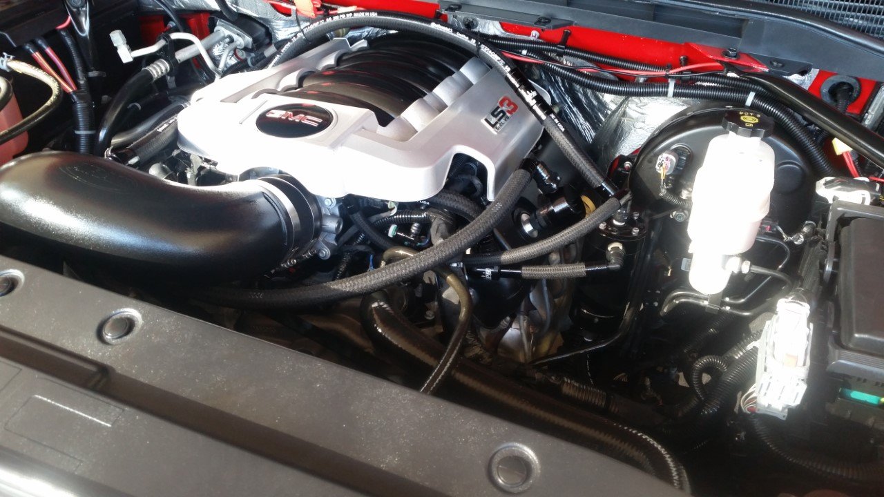

Just added my UPR Catch can /CSS
thheat
Just installed my UPR catch can / CSS.
Hmmmm hows it hooked up? I see some lines and possibly ccs. But how many lines go to the cai and where does the CCS line go to? Also how many and where are the check valves? thanks
It looks like he has a dual valve CC and a CSS. I’m thinking he has the 6.2 and has the PCV line (dirty) going to the middle (center) port on the can with no check valve. The back port off the can is going to the intake tube (not sure which barb on the intake for WOT) with a check valve. The forward port off the can is going to the intake manifold barb with a check valve. The CSS line is going to the intake tube (not sure which barb on the intake). The WOT line (back port off can with check valve) is probably hooked up to the intake tube barb closest to the TB. The CSS line is probably going to the intake tube barb further from the TB and has no check valve. Oh and the valve cover bridge line is hidden beneath the engine cover. ALL JUST A GUESS, hard to actually see but his engine bay looks good. I say 6.2 because it looks like the intake manifold line is routed to the front by the TB.
It is a 6.2 with Airaid MIT. Got the kit from Joe@UPRproducts. It was vehicle specific with CAI mod.
Dual Valve Catch Can System with CSS for CAI
This full kit with Pro-Series check valves, replacement o-rings, and
UPR Drain Valve Kit .
1pc 5030-219-1-CSS
1pc 5044-01
1pc 5044-03
1pc 2030-02
1pc 2030-07
1pc H5032-49
Yeah nobody’s saying you got a bad can lol! UPR is one of the better ones. They (me too) are curious about how you have it installed (as in what is going to where) that’s all. I bet my reply above is close!
SS502 my buddy hooked it up for me but I believe you are spot on
