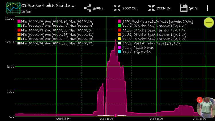

Can you open a graph display of the upstream O2 sensors and log that while driving? Or at least indicate what the display is showing when your truck acts up? I would be inclined to think, based on some rich long term fuel trims, that you're suffering from a ignition miss, presumably under load (most common) which would explain the chugging at highway speed. Alternatively, if it were indeed secondary ignition problems (plugs and wires), you could put your foot on the brake and rev it to TC stall (don't do a burnout), to see if the engine starts missing.

Did as u said PEG the throttle first gear only, what's upstream downstream on obd

Ok notice omw home from work and omw to work seems more frequent in second gear, I know I should here difference in exhaust and rpm but it almost goes quite, happen earlier running 30 -45, at 1500 rpm, didn't buck any or chuga chuga lol, but I could hear in exhaust sounded like I was just likely tap throttle. Also noticed that oil pressure is on low side in my opinion at idle it's 40 driving around 60 could this be the problem. I really appreciate all the help from everyone, I could take it to mechanic anytime but I'd rather do it myself

I have no idea what I'm looking at with that graph. Like I said, your upstream o2 sensors (bank 1 sensor 1 [B1S1], and bank 2 sensor 1 [B2S1] ) should peg rich on a full throttle run - .700 -.900 volts. If they're switching, or pegged lean, you have a fuel delivery problem.
EDIT: If that graph is a capture of when you were at full throttle, everything looks good - o2s are rich, and having no cats, the downstream look as I'd expect, confirming the upstreams are working.
In light of this, I'd agree with Carkhz316 - you may have an ignition issue - plugs, wires, coils, or coil control.

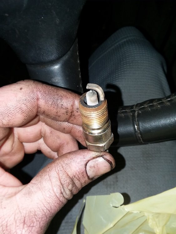

Definitely spark plugs where issue I don't thing they had ever been change, I just finished changing plugs (that far back plug on left is a bitch)and wires, check coil packs earlier been driving 15 mins include idle seem fine no hesitation no bucking and takes off like when I first got it
Good deal - glad it was an easy, relatively cheap fix. :thumbs: :cheers:
