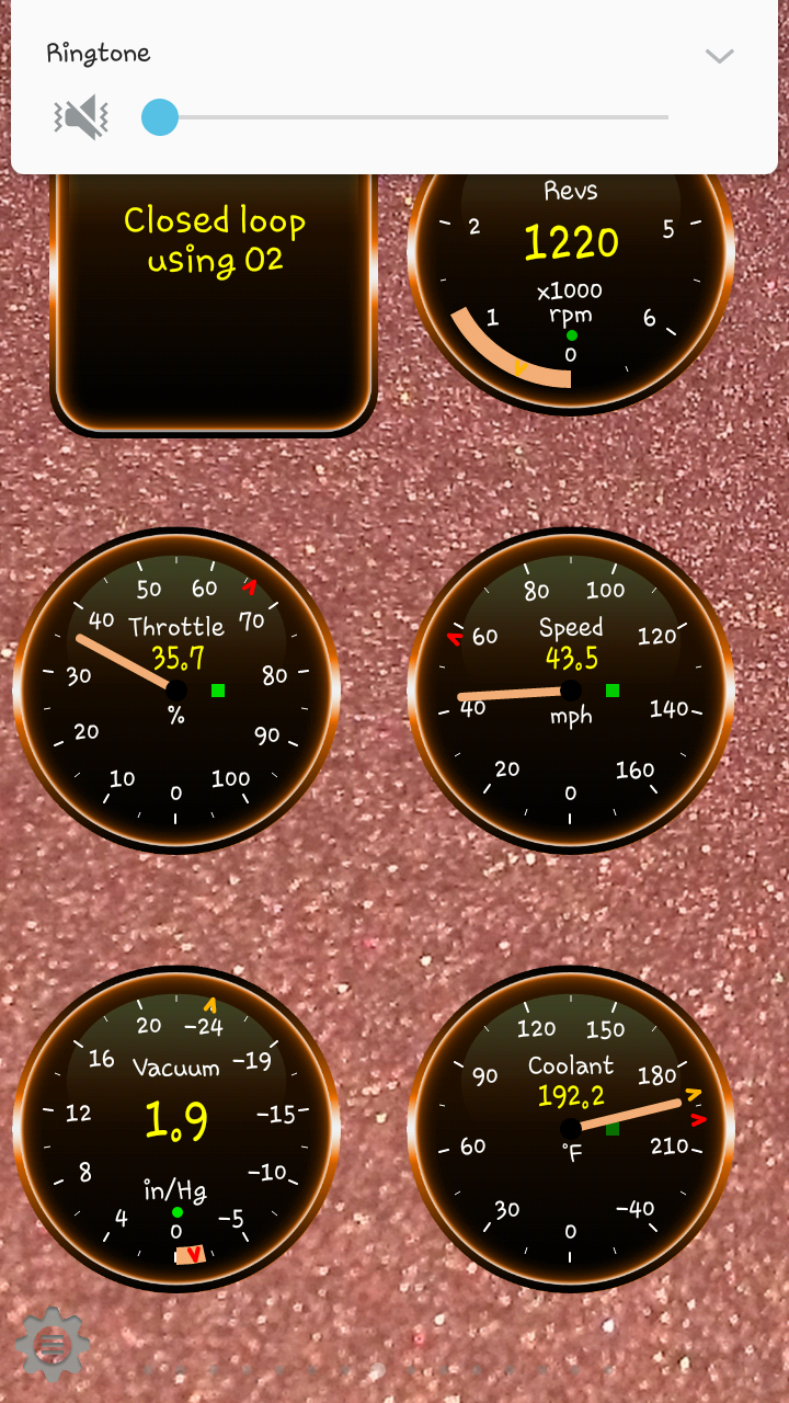

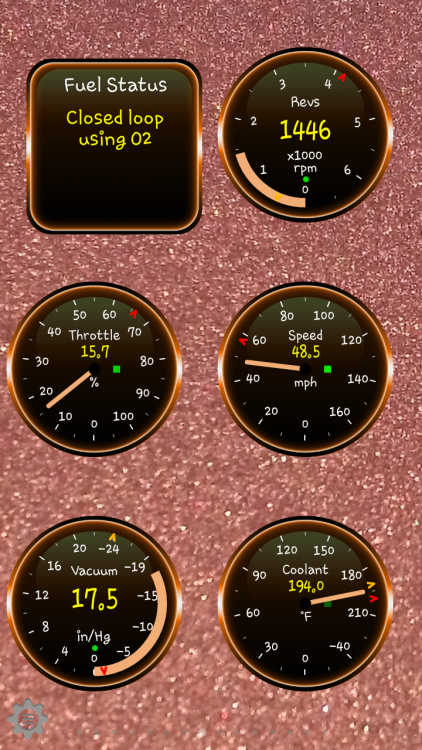

Also should of mentioned sooner I have a Bluetooth obd 2 scanner in truck with realtime readings. Pictures from scanner tool, first picture just started driving second picture went about 2 milesScreenshot_20190317-113934.thumb.png.b9e6ddeb1065dad08c4403199272cc73.pngScreenshot_20190317-114125.thumb.png.c8b09882cdf68edcef23148c47329f16.png

None of the parameters you posted from your reader are of any good. You need to post short and long term fuel trims, and upstream and downstream o2s on both banks, and MAF just in case - should be able to spot a problem within just those.

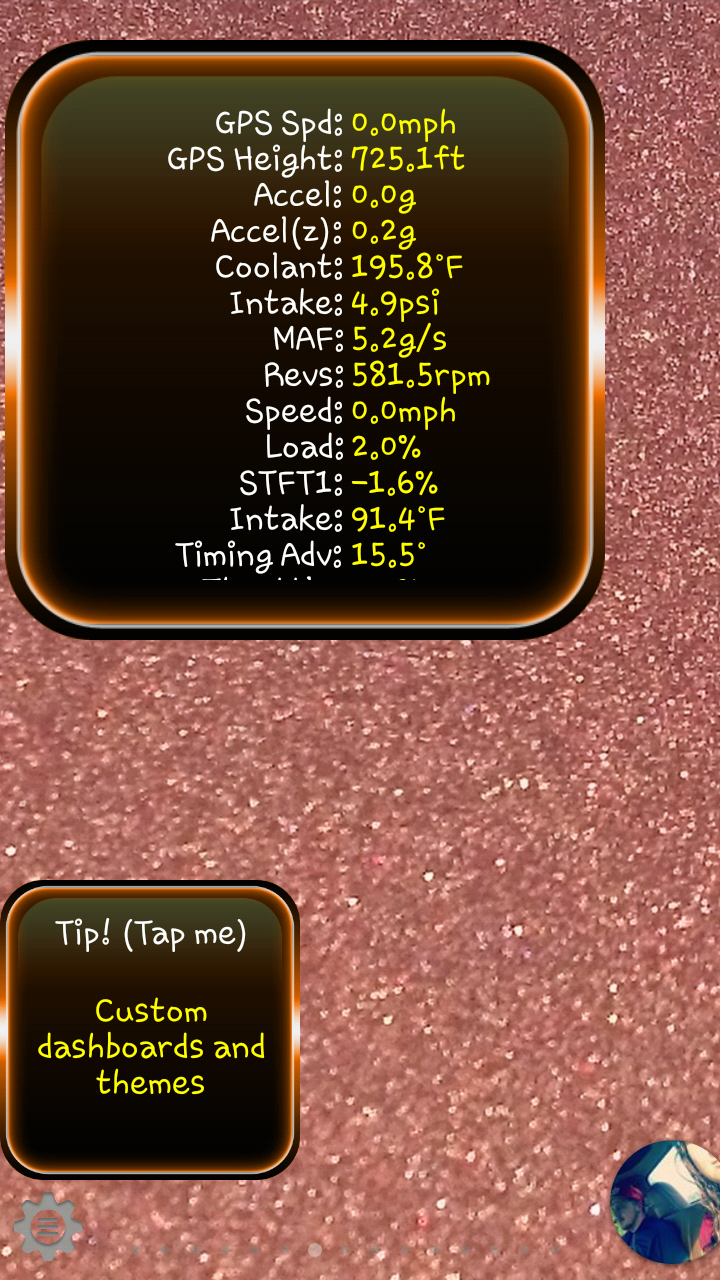

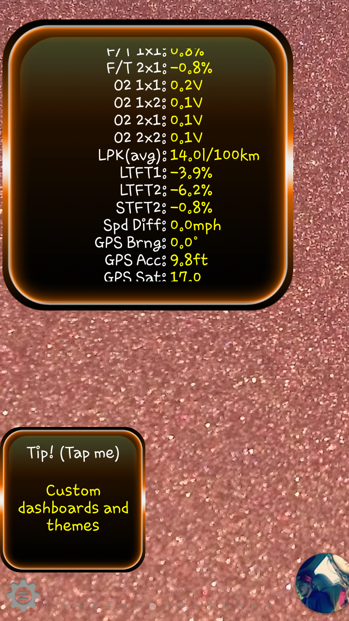

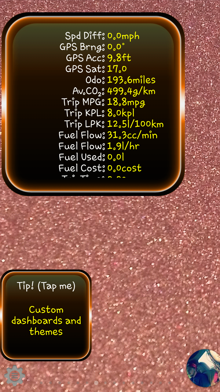

Screen shot idle before cats were removed, friday, idk if this helps, Screenshot_20190315-003956.thumb.png.203079742bb25ecdef5b97b9714e87a2.png
If it's an intake leak, it'll be the worst when the engine is cold. I use water - just poke a hole in a plastic water or soda bottle, and squirt it along the intake manifold gasket area. Best to be watching long and short term fuel trims, and look for any quick changes in the short term trims. If the leak is bad enough, you'll hear it getting sucked in. It won't pull enough in to do any damage.
Your fuel pressure is a bit on the low side, though - I would focus on that first. Full throttle run (without crashing or killing anyone of course!! 1st gear ONLY is plenty) with scan tool connected, o2 sensors should peg RICH (.800 volts or higher) and stay there. If they don't, you have a fuel delivery problem. Watch the MAF too - should see a triple digit grams per second reading, and roughly the displacement of the engine in grams per second at idle.
What are the long term trims reading?
