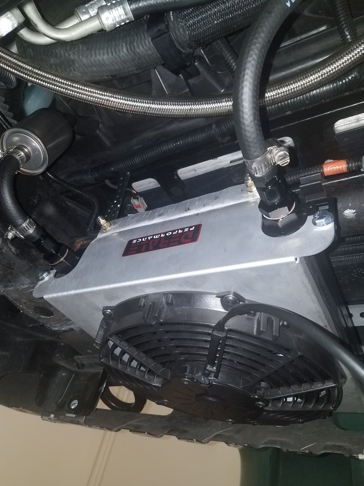

**update**

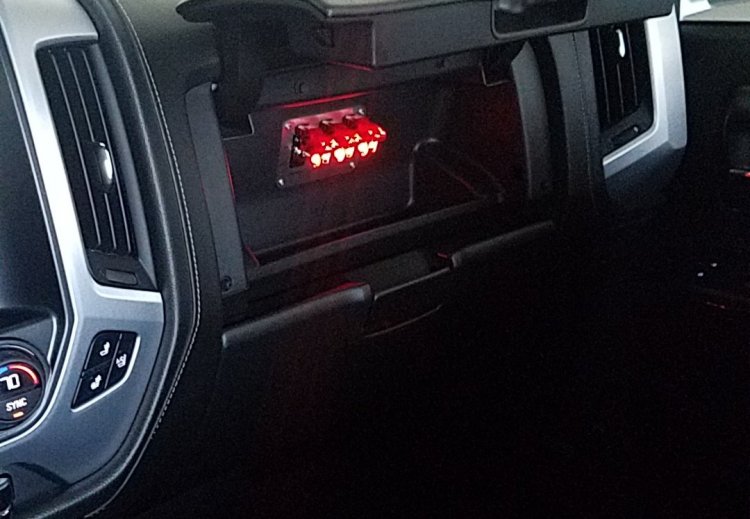

I got my performance 6L80 built with the PATC Phoenix and Sonnax zip kit. Tuned by Mike at Century Transmission w/hp tuners. Got the PML deep trans pan thinking it would help with heat. Dont get me wrong, it's a great pan, but since the 6L80's already run hot and then you go with the Phoenix kit; the clutches have more surface area and therefore, a lot more heat. I began seeing 230-240 degree trans temps with normal driving and in Alaska of all places! I gutted the factory trans thermostat, which helped zero, so I ordered the Derale part #13870, an inline trans filter, derale high temp/pressure hose, aircraft switches (mounted in top glove compartment) and the rest of the accoutrements I would need to install. Ive been running the damn thing hard and cant get temps above 194 degrees now and normally operates around 160-175 with regular driving. Phoenix kit is well worth it for the weight/hp/tq above 600-650 and the Derale cooler #13870 is not a bad way to investment $300 on Amazon. Let me know if anyone is headed down the same path and I can lend an assist with how I ran my setup. I still have plenty of room for a second cooler where I mounted the first one too. ?cheers
