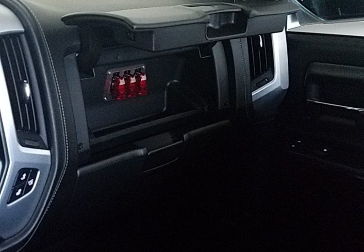

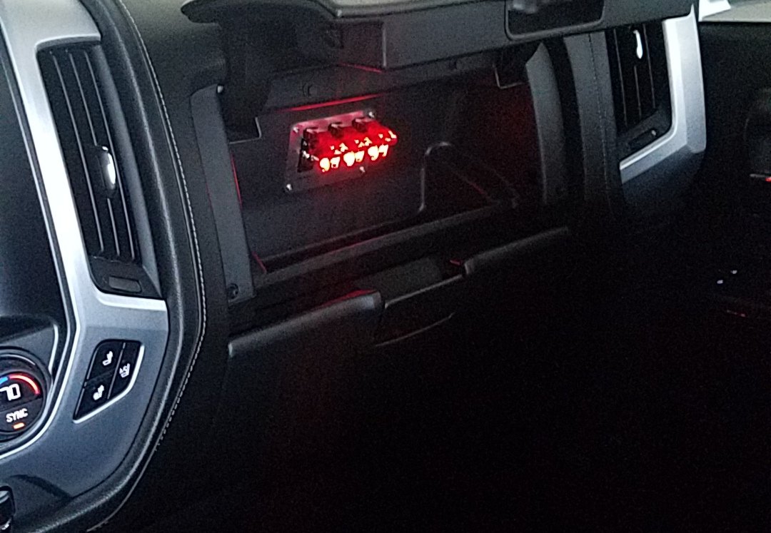

My fan is turned the other way. It sucks all (well some) of the hot air out of the engine bay and straight down to the ground. Honestly couldnt be happier with it.It gets plenty of flow, even behind the bumper. I mounted pilot switches to control my fan (in the top glove compartment) connected to the accessory, so when i turn the truck on it provides power to the switch and when the switch is on it turns on the fan (attached pics). I didnt want a thermostat, as I felt it was something else that could fail at a bad time (murphys law).
I see now. Only thing i would say is just make sure temp drops before you shut off truck. I get out of mine and hear fan running for 20secs to a minute and that is only cooling the fluid in the cooler as the pump is off.
