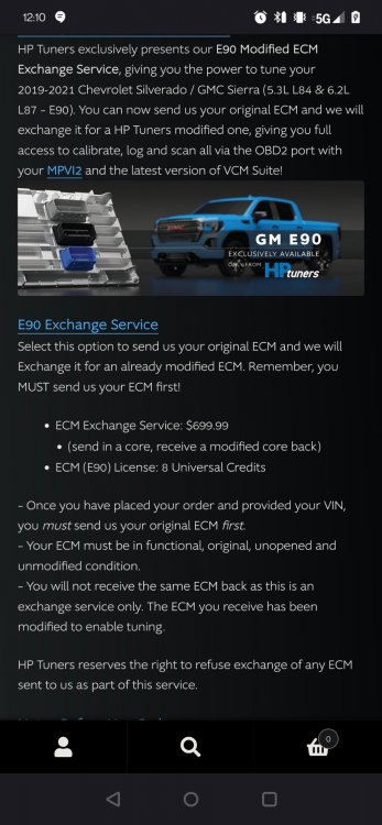

I’ve been searching all over for this info! Where do y’all find it? I saw the afe scorcher pro as well and got suckered into the pre order, but I’ve been wanting to find a way for custom tunes and a pro charger. With everything added up in the cart on the hp website, I got 2300$ and change for ecm exchange, tcm exchange, mpvi2 and the necessary 14 credits. Does this sound right to y’all? Hopefully y’all can direct me to some top notch tuners in the 6.2 gasser world. I’m coming from tuned diesels, is black bear still one of the best tuners? Thanks y’all. Sorry to kind of highjack your post.
There will be no handheld tuners for $500 available. The only way to do it is the way that HP Tuners does it which leaves out anything other then unlocking the ECM and having someone who knows the GM DI vehicles program it, unless you have that knowledge yourself. $1900 bare minimum if you can do it yourself. Closer to $3k if you cannot.
Also the 19 TCM is not a T87A so no unlocking is available on that yet. Just the E90 ECM fir now.

yeah, what he said ^^^^^^^.  Best to have a performance shop just do everything for you, take out your ECM, send it to HP Tuners, install you new ECM, and then they will do a custom tune on your vehicle... and yeah your looking north of $3K.  The days of the old hand held Superchips and such are over.
One thing to add. You cannot replace the ECM unless you have both a GM service tool and HP Tuners. So you can’t send it out and replace it on your own and then drive it stock until it is tuned. The shop tuning it will need to do it all. This will also leave out the part timers who have HP Tuners with an older interface or no access to GM service tools.
