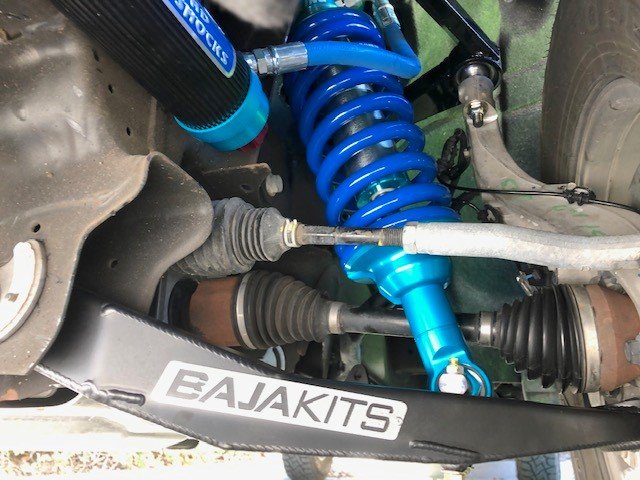

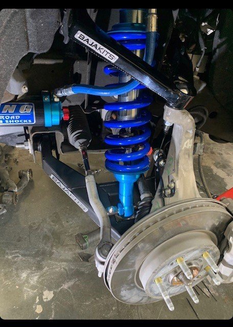

I have been waiting for this suspension kit to come out since I bought my truck. It's compromised of the upper and lower suspension control arms and is stock width. This is unique as most 'prerunner' suspension kits are extended in length to provide more wheel travel and a wider stance. I didn't want to go with a wider kit as you must use extended steering tie rods and front driveshafts, fenders, etc. and all this starts making the truck less enjoyable as a daily-driver . By going with this stock width kit I am able to keep my steering and driveshafts OEM, doesn't require fiberglass fenders, and keeps the stock geometry of the suspension.
Kit is adjustable from 0-3" of lift, although I feel like it brought up the front more than my 3" leveling kit from Moto Fab Lift did. For shocks, I chose with King 2.5" coilovers with the compression adjuster knobs all around as Kings have been the leader in the business since I can remember. These are the OEM bolt up type that replace your front struts and do not require any fabrication for shock hoops.
Once I picked up the truck from Baja Kits I immediately drove it to an alignment shop before my 4hr drive home. About 20 minutes later they called me and said no alignment was necessary..... it was spot on! Incredible; between fabrication and installation they were able to keep it all aligned with zero correction after install. Overall the ride is MUCH improved! Obviously stiffer shock valving than stock but not jarring at all. I feel like it's a good in between feeling of my 2005 Duramax 2500 and the stock form 2019 Silverado 1500. So far I've only smashed a dip in the road but even just that was handled amazingly and beyond my expectations. I haven't had the opportunity to take it off-road for a proper feel but that will be coming soon. Currently the compression adjusters are backed off as far as they'll go so I have plenty of dampening room for off-road bouncing.
Feel free to ask question or visit Baja Kits website  https://www.bajakits.com/  or instagram @bajakits (they do not have my kit listed yet as this was their prototype kit) and tell JT that Cody sent you. They should be releasing the front end kit in the next week or two) and always offer just the King coilovers that you can bolt onto your stock setup.

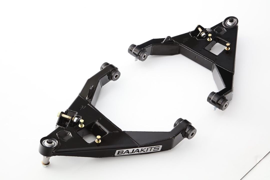

Thats a proper set up. Any idea what they are charging for the LCA’s? What’s next? Prerunner bumpers?

Lowers are going to run around $2000. I already had purchased the uppers on Black Friday. Yes to prerunner bumpers. I will try and keep these as clean and daily-driver oriented as possible. I might not be able to get rid on my rear bumper as I'm completely sold on the steps on the ends and would hate to give them up.

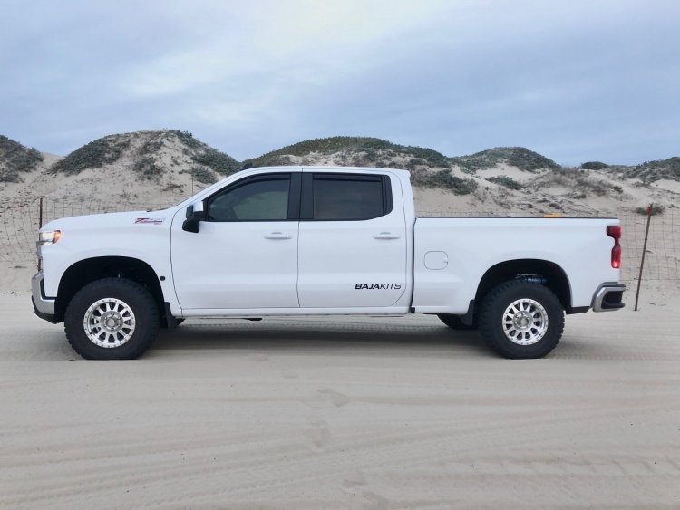

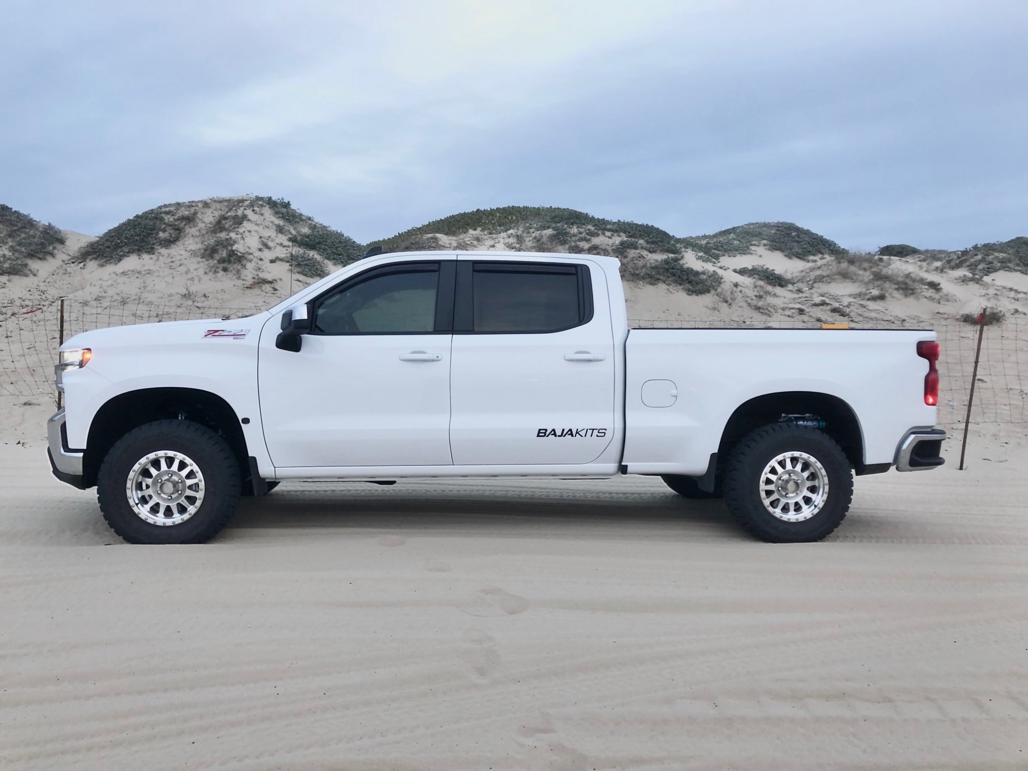

Bump need full truck pics!
I know, I know. LOL, Realized this after I posted. ?
Photo shoot scheduled today at the beach (I live next to Oceano Dunes OHV Park).  Will get some full truck pics as well as action shots.

Yes you are correct on the 'lift kit' thing. Geometrically speaking, a lift kit actually makes your truck more susceptible to damage/breaking. I thought about going with the 3.0 Kings with internal bypass but I'm really not going to romp this truck hard enough to need that. They are super Gucci though! ?
The standard short bed was tough to track down and I appreciate a longer wheelbase for offroading (more stable at high speeds).
Next in order is to finish the rear end with the Deaver U182 leaf pack and Camburg extended shackles. The leaf pack says 3" of lift but in order to keep my ride height I'll utilize extended shackles to compensate for the lift all while improving the suspension feel. After that; she'll be ready to bounce so 35's and fiberglass fenders all around!
