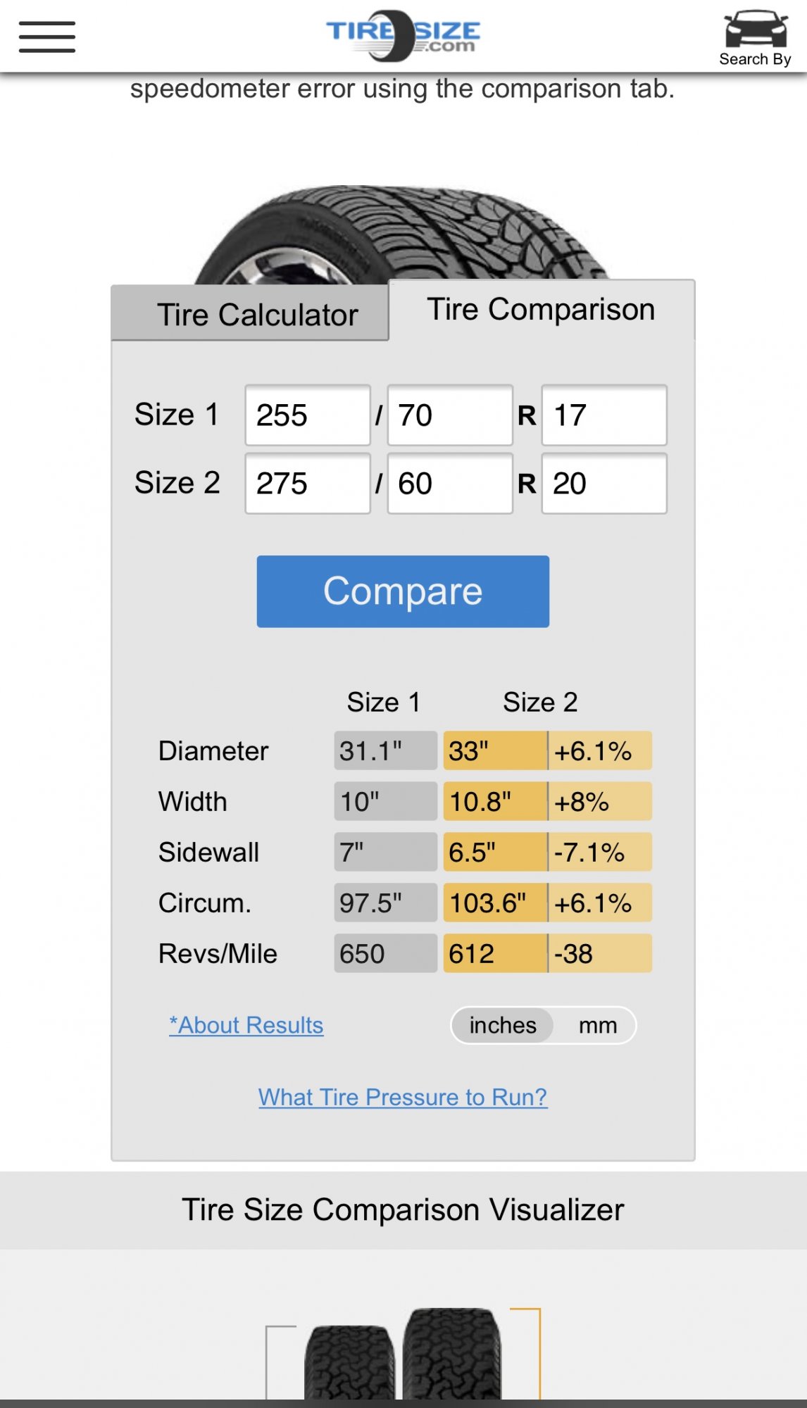

The only changes that I could forsee that would happen are the following...
1. An increase in wheel diameter of current 31.1” increasing to 33”.
2.a width increase from 10” to 10.8”
3.  A sidewall decrease from 7” to 6.5”

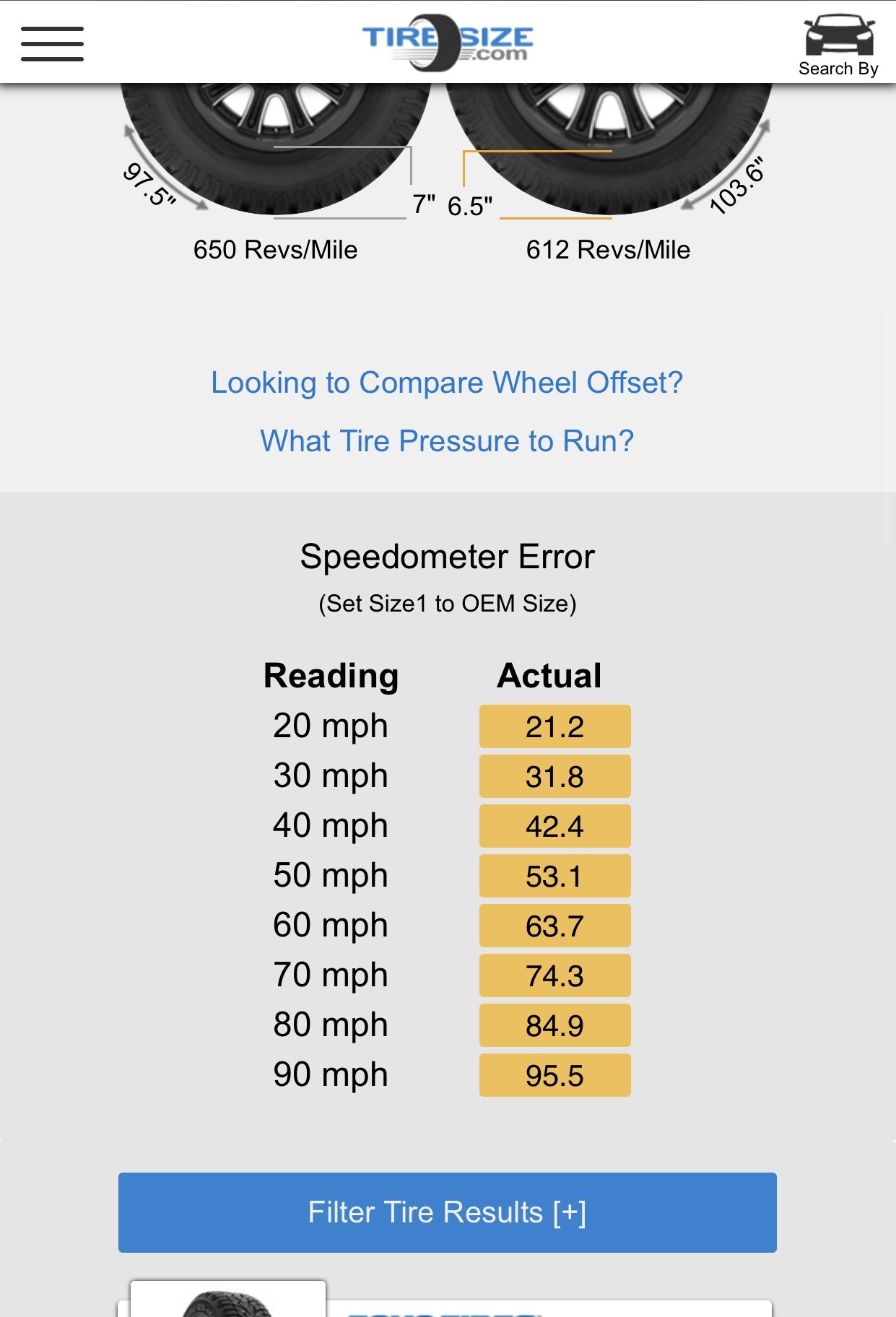

4. A revs/mile decrease from 650 to 612 (affecting speedometer speed by .058%)

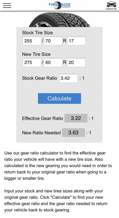

5. A new effective gear ratio of 3.22:1
6. A change in tire run pressure from 35psi to 32psi. (Annoyingly setting of my TPMS “low pressure” alarm )

3. Will I noticed the change in new affective gear ratio from 3.42, to 3.22? (I’m assuming I won’t since it is the exact same gearing/tire size as the custom.

You need to move the decimal point over in your revs/mile calculation.  If you don't get anything recalibrated, your speedo and odo will be under by 5.8%.

as far as the speed calculation(yes my original math might have been wrong), I thought I took the The old revolutions per mile of 650 and divided by the new revolutions of 612 and got 1.06% speedometer difference.  I could be wrong.
does anyone know if the new gear ratio of 3.22:1 vs the 3.42:1 will bog me down? I’m just guessing that it won’t, because the Silverado custom has this exact same set up and I don’t hear any complaints about it being slower than a work truck.
