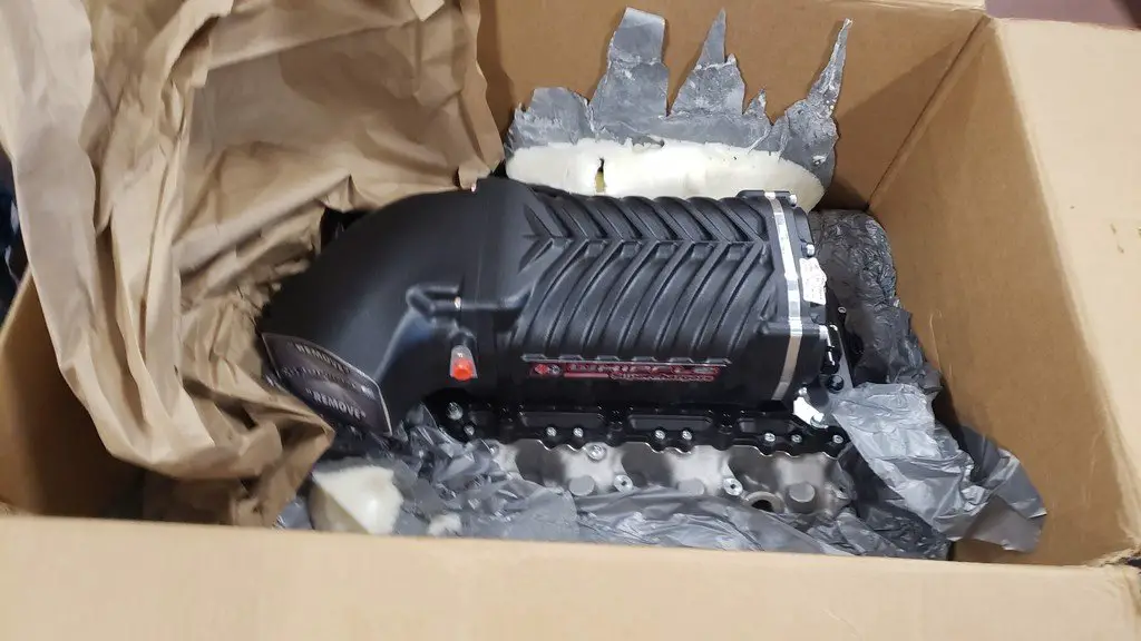

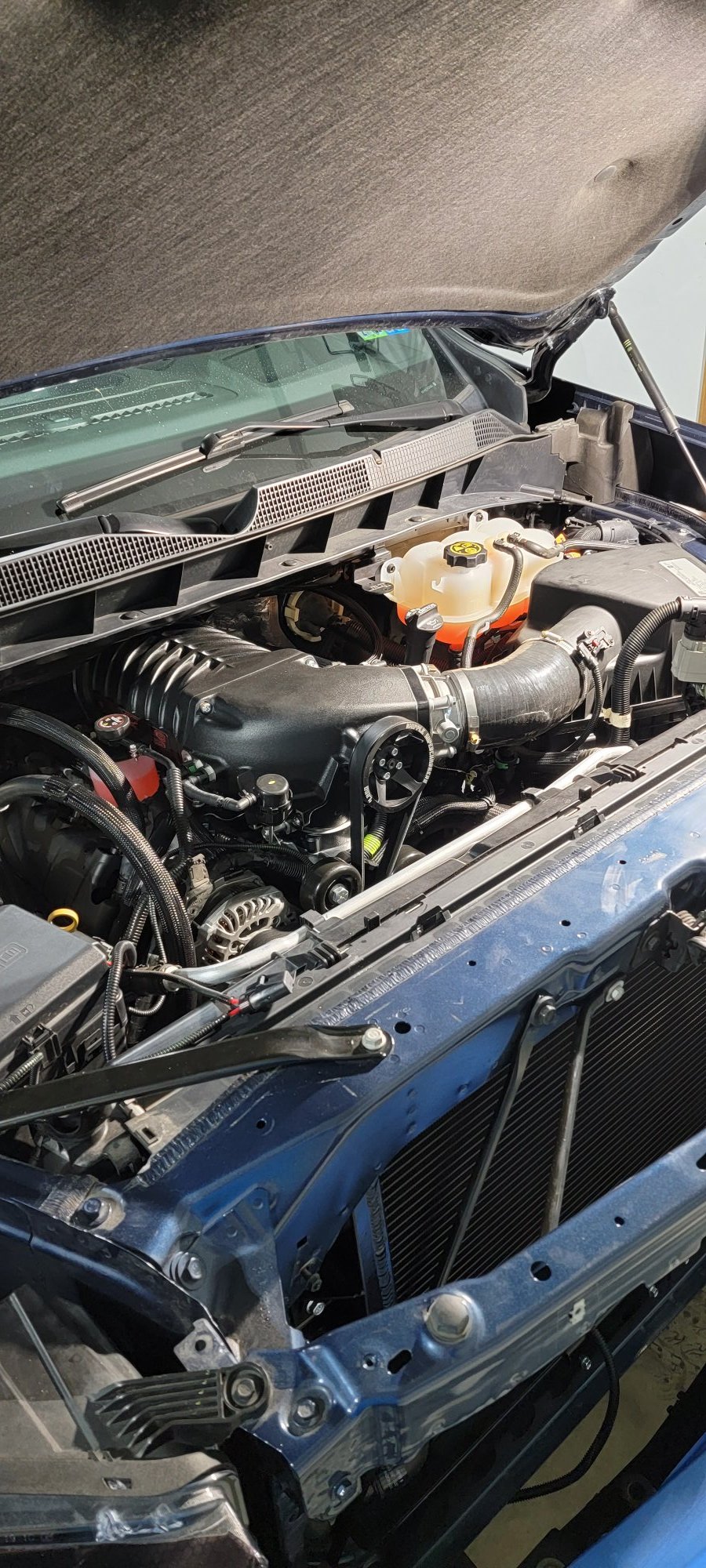

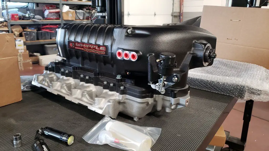

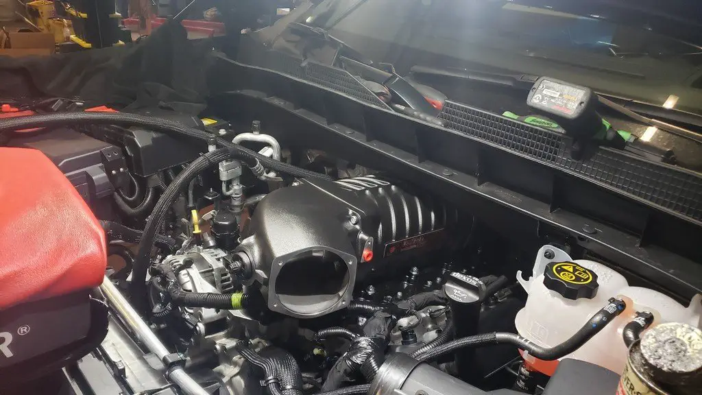

The 6.2 is pretty awesome naturally aspirated. I had high expectations, and Whipple didnt let me down. The power is pretty crazy, especially in a 4 door pickup. No check engine lights, leaks, or issues whatsoever.
Id say what impresses me just as much as a full throttle pull, is the torque at lower rpms. On the first run, i idled around the neighborhood and barely had to touch the throttle.
Haven't got used to the trans yet. Seemed like it wasnt sure which gear it wanted. Punching it from a 20mph or so roll and she seemed to hesitate on which gear to grab. I havent heard much about tuning the trans yet, but i can see the value of dialing it in. As is will take some getting used to.
Its pretty crazy how many wire harnesses, coolant lines, etc are crammed into the engine bay. I organized mine best i could, but theres just a lot in there.
Going to add a couple more lines with a catch can too.
Anyone mess with the trans tuning yet?
