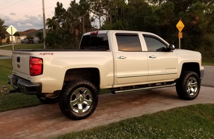

Finally got around to putting on the Zone 6.5" lift on the 2014 LTZ. Had to install a Add-a-Leaf in the rear to get it to sit level. Running 35 x 11.5 Ridge Grapplers on stock wheels. 1.5" spacers in the rear to match the front poke. Very happy with the results.

Very nice truck. Did you need a spacer on the front wheels to clear the suspension.
No, front poke is from the lift kit. Needed 1.5" spacers in the rear to make it match. I have no rubbing whatsoever.
