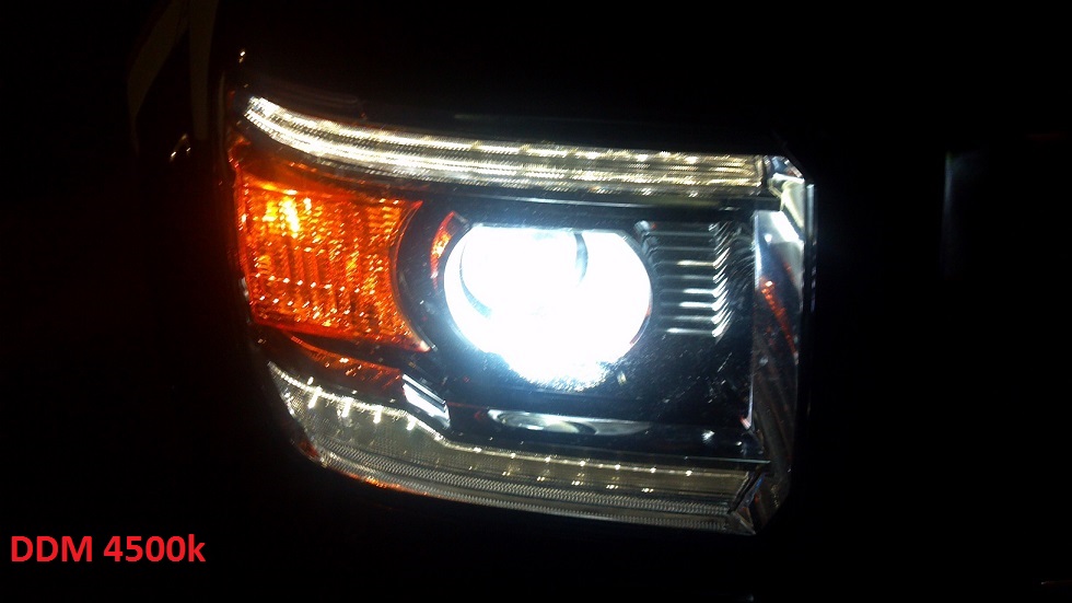

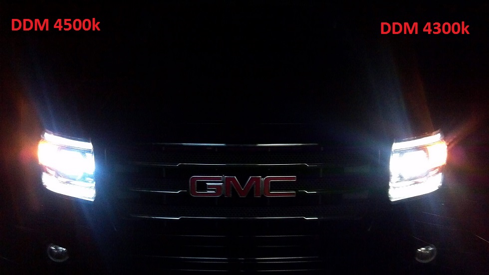

I just wanted to add some information to this thread. I recently switched my DDM Tuning 35w HID bulbs from 4500k to 4300k. I tried one of each for awhile and came to the conclusion I like the 4300k a little better. They seem to put more usable light on the road. I would describe the 4300k as white with a slight hint of yellow and the 4500k as white with a slight hint of blue. I think the 4300k match the LED's pretty good also.
