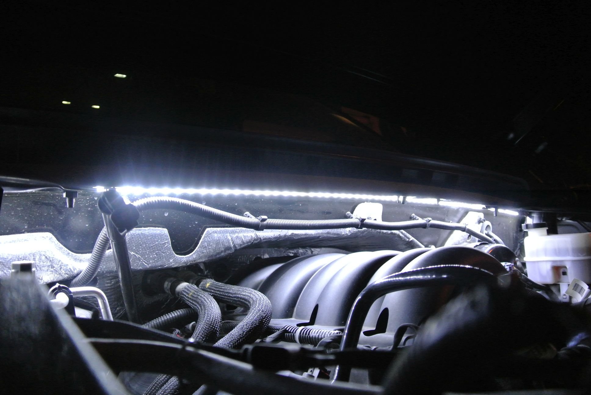

12 minutes ago, doubeleive said:
put in a underhood light
Looks good.
Any details to share? Any other shots of the light itself?
Looks good.
X2 I'm super interested in this as well!

11 minutes ago, VanguardK2 said:
38 minutes ago, JimCost2014 said:
Looks good.
I just used part of a roll of white waterproof 5630 led's
https://www.ebay.com/itm/16ft-Cool-White-5630-Super-Bright-Waterproof-LED-Strip-Light-DC12V-5A-W-3M-Tape/223129042754?ssPageName=STRK%3AMEBIDX%3AIT&_trksid=p2057872.m2749.l2649
and then picked up a standard hood pin from the local Stereo / Alarm shop
wired it up with a fuse to the battery and used the hood pin as the ground, there is already a hole in the fender near the battery to install the hood pin
i did use some scotch ultra double sided tape for the led's strip because the tape it comes with is cheap garbage
under the top lip edge of the firewall area it is flat all the way across the engine bay, I used a baby wipe and cleaned the surface before sticking light strip on
