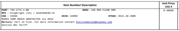

any link to those leds you found? i just checked out digikey and there is an ocean of them hahaha 😰
Took it apart from the back. The PCB is attached to the back white molded piece, which is held in by small clips. A few small screwdrivers and it's simple to pop them apart. The round knobs for volume and temperature control are held in with clips so I just used a few small flatheads to wiggle them off, which you'll need to remove before you can separate the PCB from button cover piece.
This is the only other picture I took, I had a spare HVAC unit that I practiced on before attempting. One helpful tip would be solder some leads on the positive/negative sides of a 3v battery to test your LED's individually before reassembly. This way if a connection isn't making contact you know to reset and resolder each end of the LED. I believe I just took a calipers to find the overall dimensions of the LED and filtered by that on Digikey, then ordered a few different variations depending on forward voltage. Looks like I ordered them in red (I want to say I attempted to switch all white LED's to red but it didn't look very good lol) but below are snips of the part #'s from my invoice. Definitely a starting point for you, because as you found out there are hundreds of thousands of parts on digikey haha.
Another way to determine voltage of each LED would be take the HVAC unit apart and plug it in. Use a multimeter to find the forward voltage of those white LED's while the parking lights are on. If my memory is correct it was around 2.8v? Let me know if you have any more questions, my inbox is always open!

awesome!! thanks dude!! i'll let ya know if i have any questions once i get into it, but it actually seems pretty str8 forward once getting the unit open as far as what's what.  i'll just have to be patient with that since these plastics are brittle on parts like this,  thanks a ton for the LED info tho, haha that was gonna be a long drilldown.  😂

haha holy dog sh!+... they DO!
https://www.superbrightleds.com/moreinfo/surface-mount-smd/cool-white-2835-smd-led/1843/4456/
But also Digikey is in MN... i think either would be getting these from China anyway, and both list them as in stock and able to ship today.

I can't remember how long my digikey order took last time, even though they say both ship today it may be next month before you get one of them lol
I didn't even notice that invoice was from digikey.
I got them next day due to being only 2 hours from their headquarters.. Wondering if they stock certain parts (small easy to store items) at their HQ and I got lucky with these LED's I ordered.
