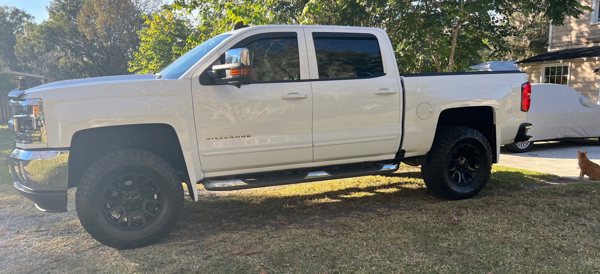

Put on AVS in channel Vent Visors I got today. Truck had the tape on type until a couple of them came loose.

Any problems with the windows opening/shutting and do you notice any difference with the wind with the windows open? these trucks are terrible wind wise mine is like a tornado inside with the windows open

If I let driver's window auto up it will go back down.

I'm like you, I don't know how loud it would be without it because I put the AVS in channel visors on right away back when I first got my truck in 2016. But the window should stay up when doing the auto up. I know I can either manually raise the window or auto up and it works either way. I have seen other threads with same issue but don't recall exactly what the fix was. I think I tried to leave the window closed as much as possible when I first installed them.

From what I recall, the AVS instructions mentioned rolling window up and down 5 times and then leaving them up for 24-48 hours. Also another possibility is to do the reprogramming which is a simple as rolling down the window and then manually closing all the way and holding switch in closed mode for 2-3 seconds.
And I also found this post in another thread that has more steps to follow:
Here's the short version that works (it's actually a GM-approved procedure):
1.  Roll windows all the way up.  As the window closes hold up button for 3-5 seconds.
2.  Roll windows all the way down.  As the window opens hold down button for 3-5 seconds.
3.  Roll windows all the way up.  As the window closes hold up button for 15-20 seconds.
4.  Leave the windows closed for 24-48 hours.  More heat/sun is better since it lets the vent visors mold around the weatherstripping.
Has worked on most of the trucks we have dealt with ....
