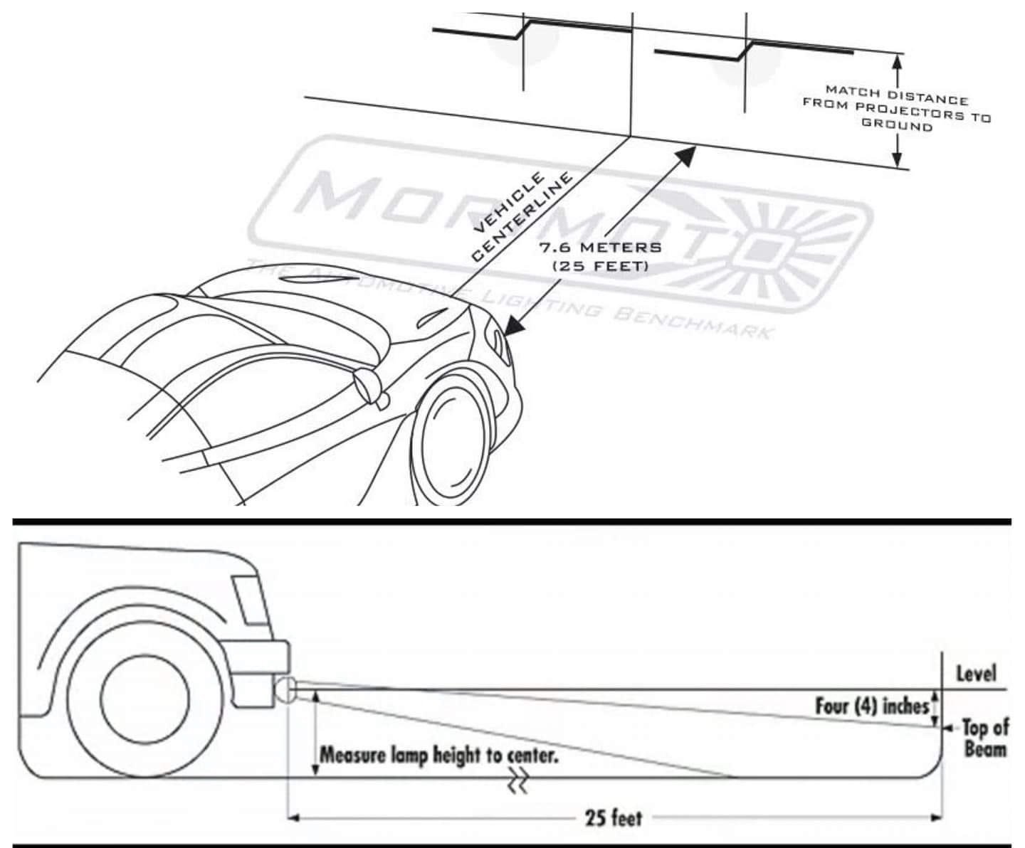

got a package, hopefully i can get them on before another week of stormy weather hits again
Looking forward to seeing the output! Don't forget to aim them 😆
Ya I tend to aim mine a "smidge" high but not much really depends on the light output pattern I don't purposely try to blind people

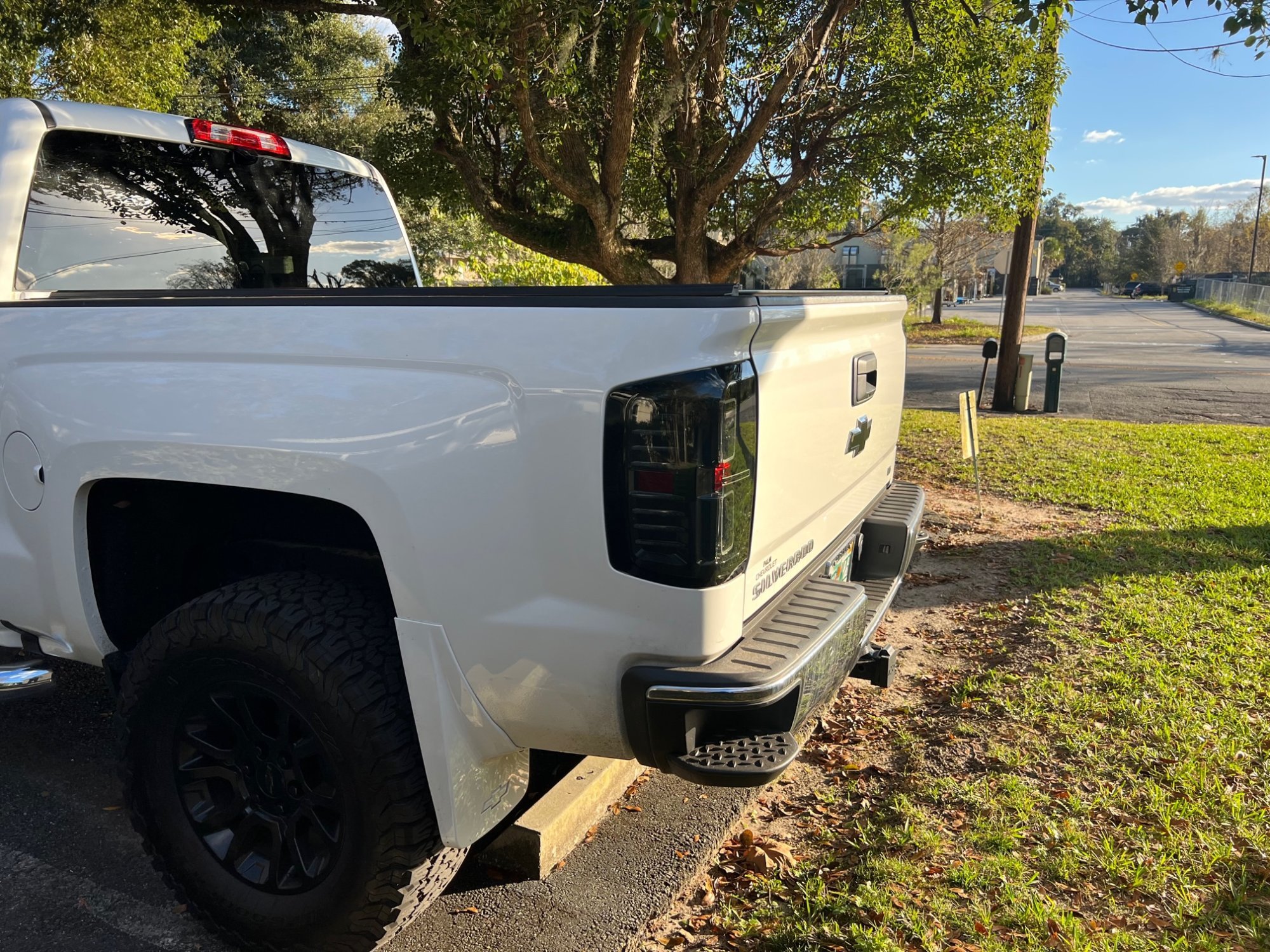

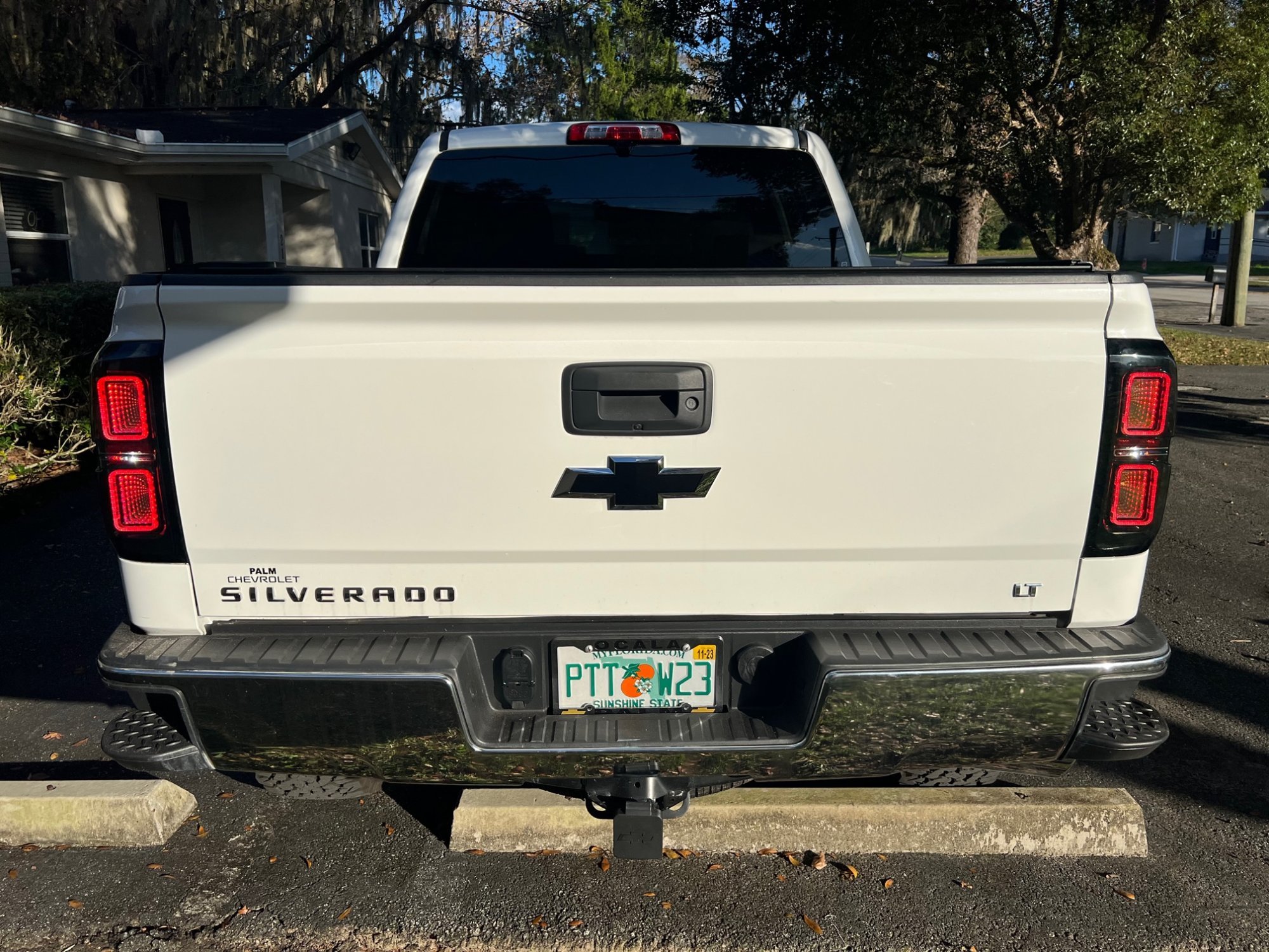

Bought myself a Christmas present. Morimoto XB LED tail lights,
More pics to come at night time... probably tomorrow as I'm having dinner on Christmas with a retired IBM CEO - I'm so going to geek out! :)
More pics to come at night time... probably tomorrow as I'm having dinner with a retired IBM CEO - I'm so going to geek out! :)
Merry Christmas!!!
Very nice, those look Great!!! You have good taste in picking out gifts for yourself😁

2 minutes ago, JimCost2014 said:
Merry Christmas!!!
Thanks, Jim! Merry Christmas to you and all of our great contributors!
