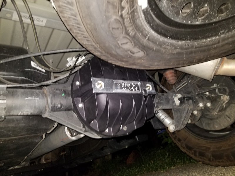

Swapped a differential cover on my 2018 with 7k, just because. There was no build up of metal shavings, just typical fine black and gray microscopic stuff on the factory magnets (one on the housing, one on the factory cover).
I replaced it with a B&M 71506, because I was intrigued by the addition of load bolts to prevent deflection. Since I like to accelerate hard, I figured this would balance out some of the "wear and tear" I cause. It definitely makes fluid changes more expensive (4 quarts, instead of 2), but easier since it has a drain hole. I reused the factory gasket, but had to modify it a little to work around the new drain hole location. Just trimmed some rubber, no metal.

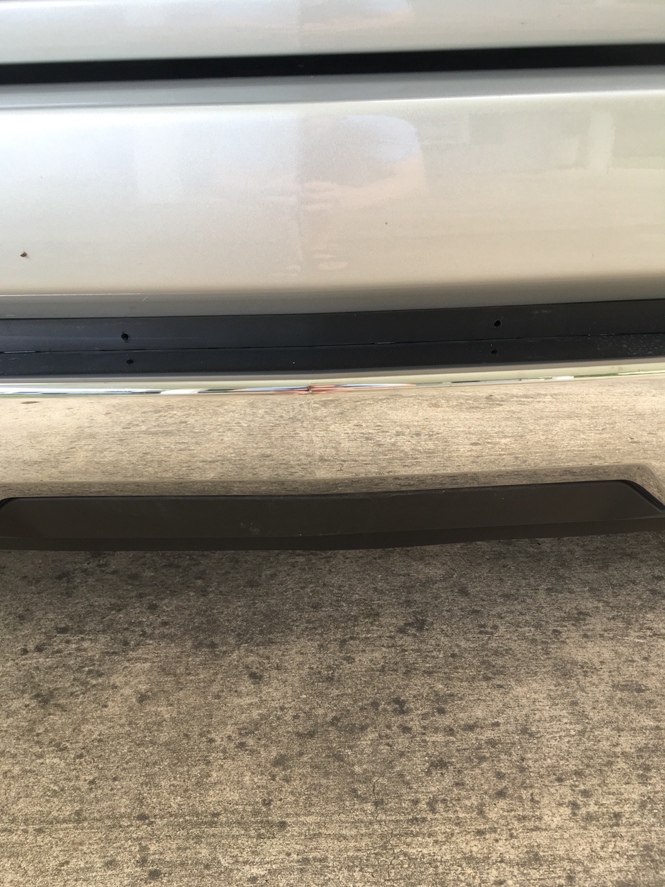

Spent about an hour this morning putting back on my side steps (wife was complaining of the difficulty getting into the truck easily without them) and installed the new trimmed lower air deflector (HUGE thanks to @Mikeb52r for coming over yesterday and being a dremel ninja).
