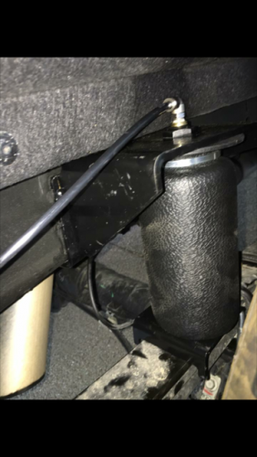

Do you notice and ride difference when not towing with this kit, at the 5-10min psi? I have a new kit sitting in the garage waiting to be installed. I have the 3" rear blocks and bilstein rears as well.

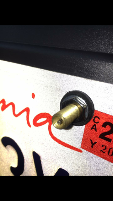

Not at all, you can squeeze then when that low. Do you have the same exact kit? Are you installing a compressor? If not, take the bolts out of your rear license plate and run your valves through the holes then nut back on the plate. looks clean and easy to get to.

Yes it the same kit. No compressor. Only tow a couple times a month at most so don't see the need to spend the extra $ on it.
