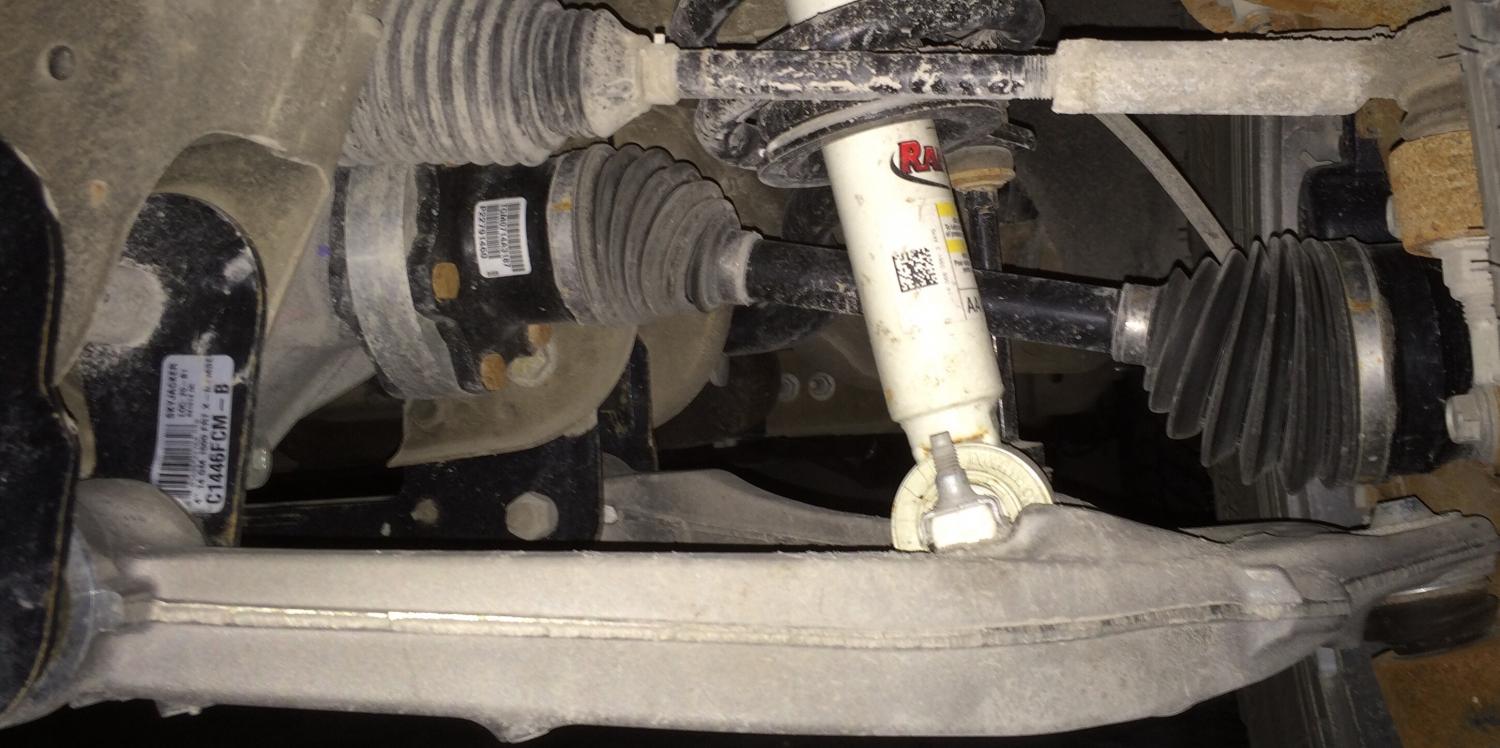

It does but not noticeably like other lifts, very minor. I'll try to get a side pic for you sometime.
I'm assuming the only downfall to this kit is that it uses strut spacers not trying to bash just trying to learn from skyjacker I hear 50/50
Skyjacker gives you the option of the strut spacer or for little more money getting the longer strut. This was my first suspension lift previously having the rc 3.5 lift on my other trucks. I couldn't decide between the zone 4.5, skyjacker or rough country 5. Seen this lift on jade Robertson duck dynasty truck and made the decision. Front measures around 42.5 and back is close to 43.
Angles are good, nothing to worry about there.

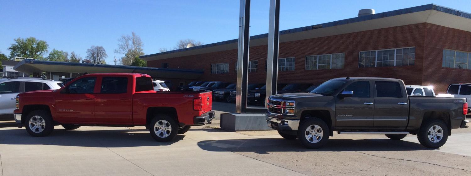

Any chance you'll still be able to get some pics of yours next to an un-leveled/un-lifted truck?

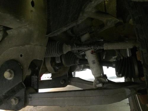

Can you post pics of your angles? I read the install instructions and it looks like it only drops the diff an inch. So I can't imagine the CV angles are very good.
Yeah im still waiting to drive by a dealer with a new one sitting out, then ill shoot a back to back shot.
