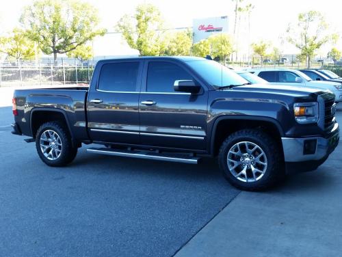

what ever you decide, don't go over 1.5in. These trucks need to maintain 1.5-2 rake in the front to look right. A "true" front to rear level looks like garbage IMO.
Plus, the ride characteristics really start to change when you go higher that 1.5.
I have tried every level made between my old 2014 and new 2016 ( top, bottom strut, Bilstein 5100, Rancho Quick lift) I can tell you - 1.5 in under strut with stock socks is the best IMO. ( look and ride)
I have a 2015 Z71 Crew with the Top Gun 2.5" leveling kit, and it's been aligned since install.  I also have an add a leaf on the rear, but all else is standard.  The rake and height are perfect, IMHO, but on uneven pavement there's an annoying noise up front coming from what I'm pretty sure is the struts.  The TG kit has two leveling plates on bottom and one ring on top of the strut to get the full 2.5".  I've also done the 1.5" version with one plate on bottom and the ring and had approximately the same noises from the strut.  Do you think I'd lose the noise if I only do the plates on bottom (only one set of plates and no ring, which would be only a 1" front level)?
I think I'll then have to remove the add a leaf and do a zone 1.5" body lift to get back to where I am.  But I want the factory ride back.
