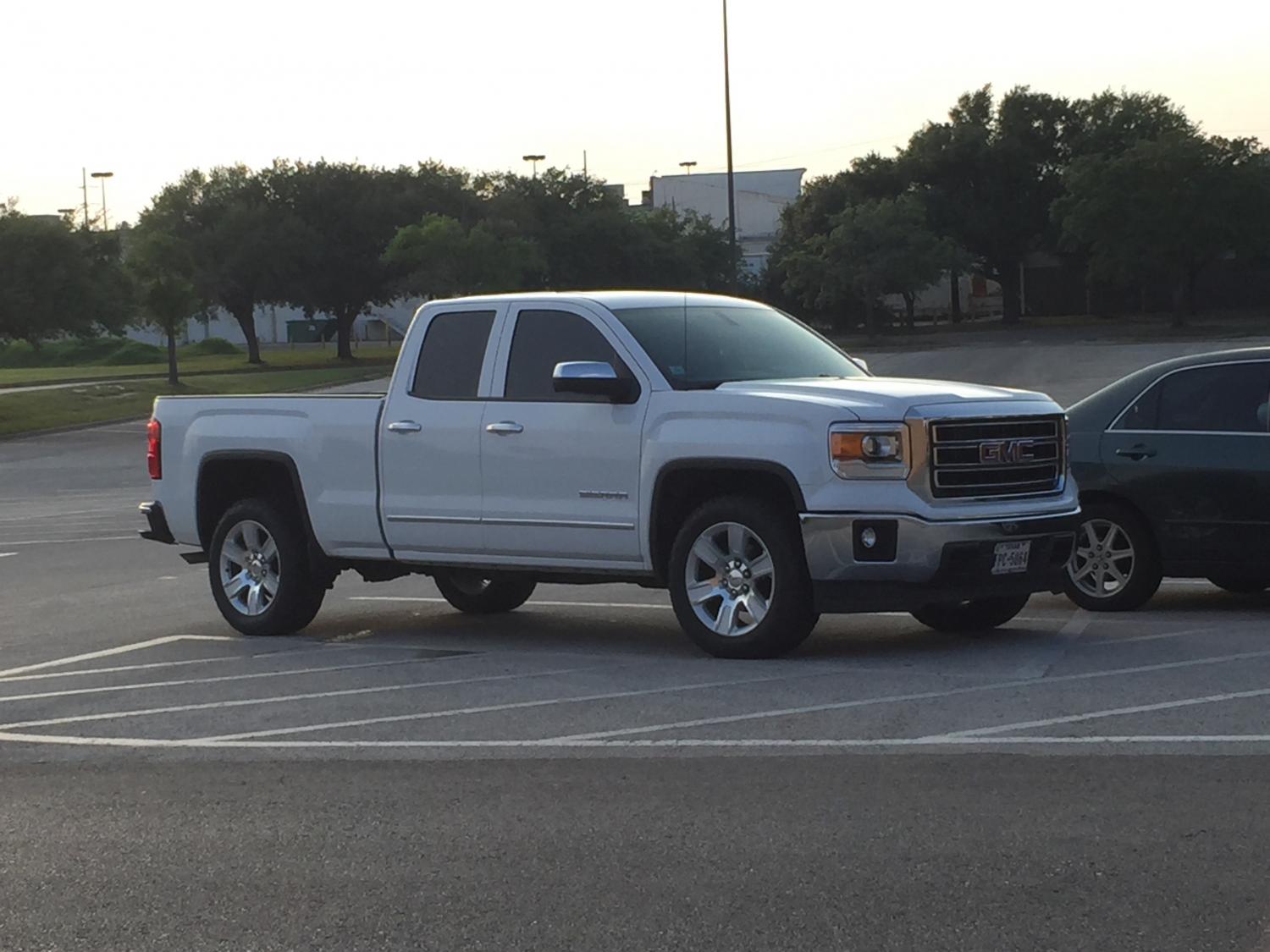

DONE!! That was the most tedious work I have done on my truck so far, but it was worth it! The pic worked perfectly as a template by the way! I attached two after shots and one before shot.

Looks like SLT now :)
Thanks y'all. Now I'm just terrified that they are going to fly off going 80 haha.
