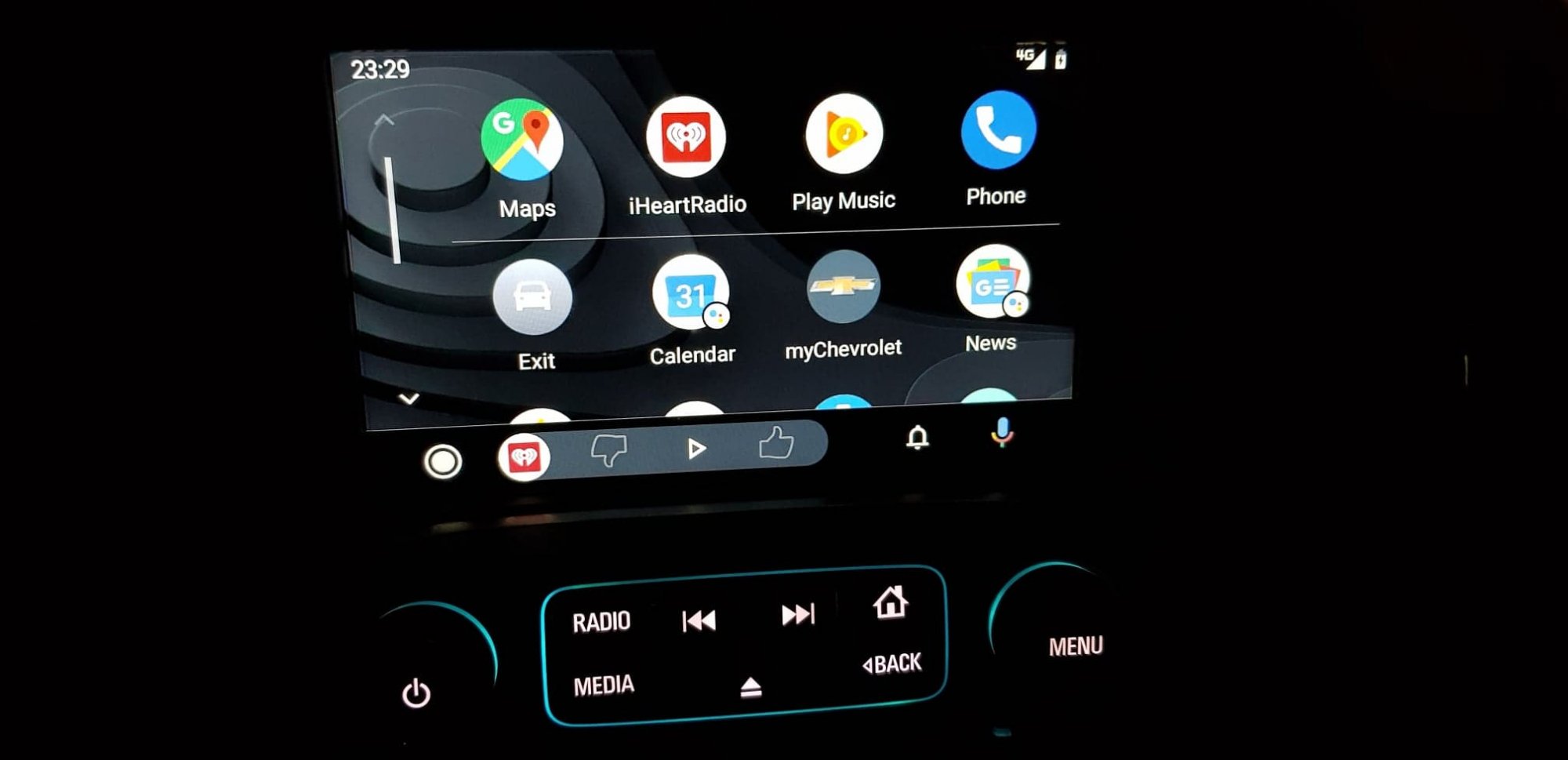

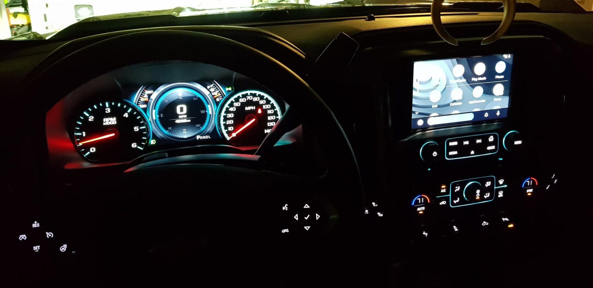

Once again, WAMS delivers! Thanks to @GTPprix Chris for a great job and fast turnaround time on my cluster. I didn't get much time to go through all the options, but everything works so far and looks good! And the AA update that Google pushed, updated on the same day I installed this(8/6/19) and if feels like I got a new truck.. ?
If you're looking to install one in a 2017, you can use 84505073. That's what Specmo sent as it superseded 84201626.
complete_dash.thumb.jpg.6a868f191bdf08904d23ac62fcb7ba71.jpgnew_AA_interface.thumb.jpg.6259ff829d2e437991780ebbaae8ebfd.jpg
