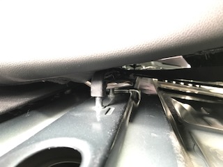

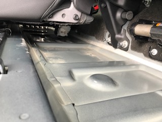

Thanks for the picture you have saved me some time today. I was planing to pull the single seat to do just that, fold it up and see how much room I had. Looks like my only option may be the front seat.
Thanks for all the great info everyone. I will be working on this today and will make sure to post pictures and results of what happens. At the moment it looks like the rear seat option is out so I may try the front seat. I also got a nl4 connector so I can quickly disconnect it if I do end up having to go under the rear seat at lest I can take it out but that would be disappointing. What have I got to lose other then some time. I'm trying to avoid under the rear seat since my large dog ends up occupying the back pretty often when I'm going to and from our river lot and pulling the rv.
