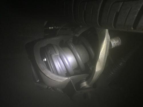

Help me identify leveling kit on my new (to me) 2014 Crew Cab 4x4 to f
Can anyone identify the leveling kit used on my new (to me) 2014 Silverado 5.3l?
Height in the front is 40.1" and height in back is 39.4". I believe the prior owner installed a leveling kit, but I don't know how to identify it. Can you please assist?
Below is a picture of the driver side strut.
I'm not sure, but it doesn't look like that has a leveling kit on it.
Do you suppose they could have just dropped the rear?
Show a picture of the bottom of your strut. Level spacers are commonly found at the bottom of the front shock. I doubt the back was lowered as the 39.4 sounds like the factory height.
40"+ in the front is definitely not stock height. Some kind of leveling or lift kit is installed. Bottom of strut may have a spacer installed with a label marking the manufacturer.
Might be a 3 inch top spacer level kit. Need better pics to be sure.
No bottom strut spacer at all. Will get pic of top spacer and post.
Can I simply remove the top spacer? Or will I need to buy additional OEM hardware for the strut?
Also, I have read at least one forum member resolved the clicking by using only a RC bottom spacer 2" leveling kit. (he removed the top spacer).
Will a 2" level still allow the use of my current wheels/tires? (305/45r22)
