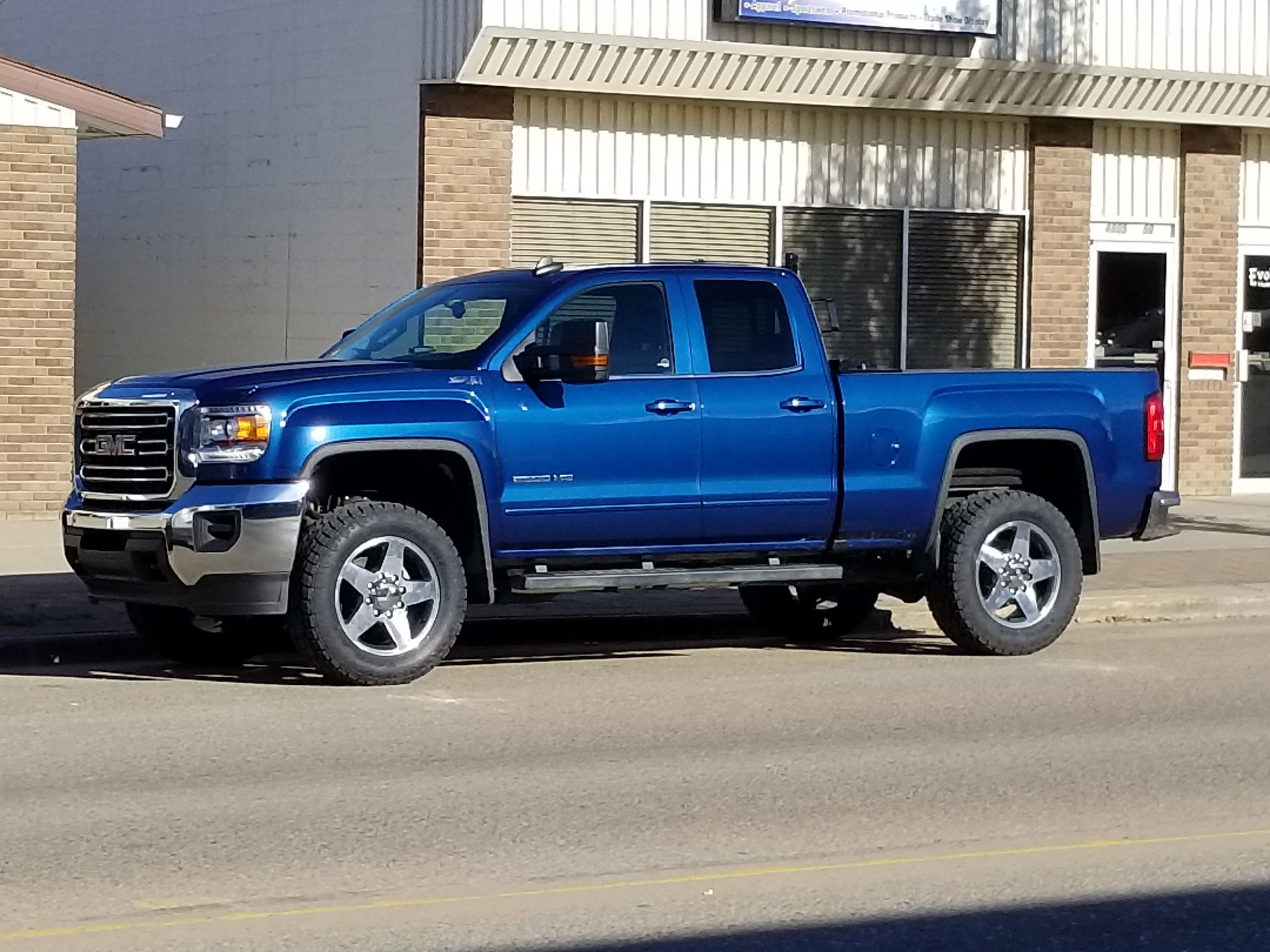

295/60R20 on cranked stock keys.  Could easily go up to a 35 as these have piles of room.  A arms don't hit and nothing rubs.  The picture is deceiving by angle... I have one inch of rake front to back.  Total cost was 28 bucks for shock extenders lol.
Looks great!
Can't believe you didn't waste a ton of time and money installing a leveling kit...
1 hour ago, SMiller said:
Looks great!
I know huh... It's so weird.... lol.  Even one of my own employees bought keys and I think a arms for his 16 Duramax... sits about the same height as mine and has the exact same tire on the truck lol.  I just give up with people haha.
