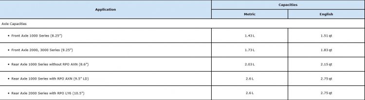

2007 Avalanche Differential Capacities
I've seen several conflicting reports regarding the fluid capacities on both the front and rear differentials on my 07 Avalanche. The manual does a great job specifying the gear oil types but seems to be lacking the capacities part in the "fluids and capacities" section. :lol: Anyone have a good answer for me? I sure would appreciate it!
This is from the book! Hit that like button! Pictures cost me a FORTUNE!!! ;)
