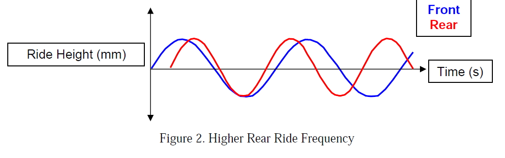

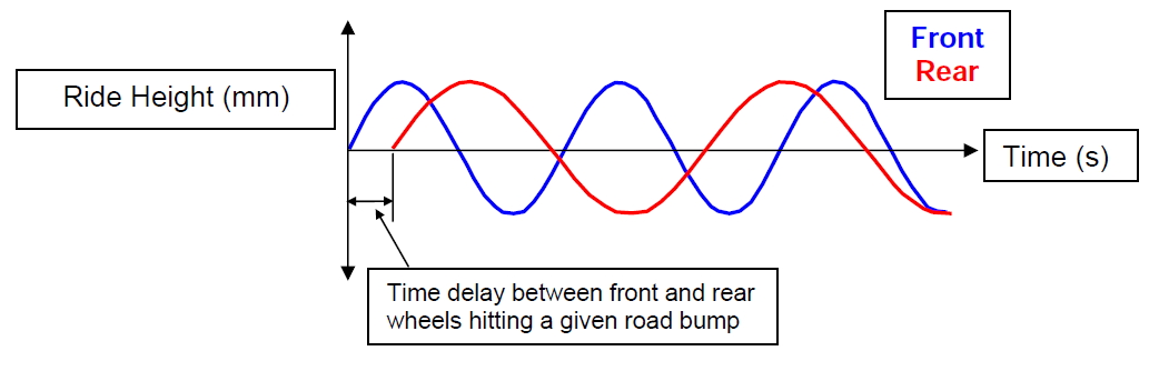

In Vehicle Dynamics, you're not allowed to cut the truck in half and treat each end separately.  They are connected by a single chassis, the way one end reacts has an effect on the other.  When you add a large mass to one end, you lower its natural frequency (increasing spring rate will raise the frequency).  When the rear suspension's frequency is lowered below that of the front, you get ride problems.
When a bump is encountered, the front hits it first, giving an "out of phase" input to the chassis--with the rear following the front.  If the rear frequency is lower, this makes the problem worse putting them farther out of phase for the first cycle or two (which matter most because the shocks are not able to damp out the movement for these cycles).
You get this:
Here you can see when the front end is at maximum height from its first full rebound from the bump, the rear is at its lowest height.  This pitches the vehicle.  Automotive Engineers have known for decades the human body is much more sensitive to pitch than it is to straight vertical movement.  This is the "front end bouncing, truck bouncing, porpoising feeling" that makes the truck feel out of control, makes people sick...makes them go out and buy a 2500 or 3500 (which come with stiff enough rear springs from the factory this is rarely as much of an issue).
When the rear ride frequency is higher than the front, the rear of the chassis tends to "catch up" with the front, reducing the out of phase response.  Like so:
This allows the chassis to act as a unit with a more pleasant, less noticeable, more controllable pure vertical movement.  And that's how stiffer rear springs can reduce or eliminate the "front end bouncing, porpoising, truck bouncing" issues many have when towing large trailers with the softly sprung for a passenger car-like ride 1/2 ton.
Does a WDH also fix the issue?  A WDH certainly can reduce it, but to a lesser extent.  When adjusted to safe levels you really aren't "transferring" that much weight--the rear axle still has a large amount of additional mass its springs need to control.  You still end up lowering the rear ride frequency a large amount.  This causes many users to adjust them to unsafe levels to get an acceptable ride--or as they often call it "knowing how to use it" or "getting it set up right."  That's why people who have some sort of ideological aversion to improving their suspension if a WDH is used, as if it is an either-or choice are misguided.  "Not needing" and "getting by" without should not be confused with "optimum" or "safest."
And that's just one aspect of a very long list of ways stiffer rear springs help when towing a large trailer with a 1/2 ton.  Restoring suspension travel otherwise eaten up by the rear end sagging helps keep the axle from having to bounce off the bumpstops as much when driving down the road (which can really ruin your ride on a rough road).  It reduces the amplitude (total movement) caused by road inputs reducing the "tail wagging the dog" feeling, the feeling that weight of the trailer is "having its way" with the truck, pushing the rear end all over the place, etc.  It really doesn't take a large amount of study in Vehicle Dynamics to get the concept that stiffer springs are going to handle large amounts of weight better than soft springs.  It's a pretty simple, self-evident concept--easily observable by any user who actually tries.
