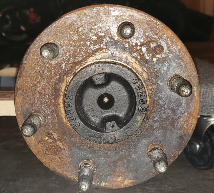

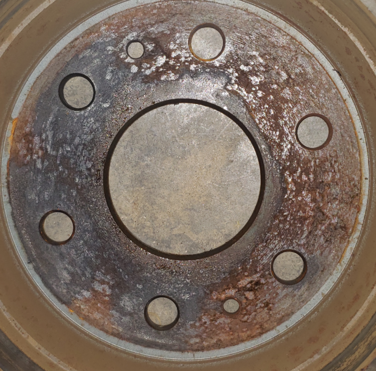

 I installed new Yukon axles, wheel studs, brake rotors and pads. It made a significant improvement to the point that I don't dread taking this on a 1400 mile trip. I can now hear the tire to road contact over the low resonance and vibration the truck had on the highway.
I have attached images of the axle and rotor mating surfaces. Notice some of them on have 50% at best contact and that's just on one side of the bolt circle. I imagine there would be an improvement in just pulling the rotor off and rotating it 180 degrees and reinstalling. The wheels were torqued to 125ft lbs, so it should have complete mating around each lug.
2.thumb.PNG.6bebd7e0e8d871a598d2a0c663063b16.PNG3.thumb.PNG.e8fce6260643d71e95611ef70260ba8b.PNG
Glad to hear KLVR6.  I'm in the same boat.  I never would of taken my truck on a family vacation, but now we are planning on taking it this Christmas.  85K later. Our trucks have a stiff frame, stiff suspension and are designed to carry quite a bit of pay load for a 1/2 ton.  So let's face it, when empty any machining imperfections are felt.  Driveshafts run out, Driveshaft balance, Gears that have different mesh patterns and yield varying backlash, axle shafts are a crap, rotors that are not mill-balanced etc.  It all compounds.  Plus, I think removing the carrier and bearings and cleaning all the surfaces and re-torquing the bearing caps back to 63 # is a good idea.  Should there be debris from the German, I mean Mexican axle manufacture facility it will only cause more problems.  My E39 and E90 BMW's may have been expensive, but man I loved the way things went together.  Von Braun machining for the type A in me.
