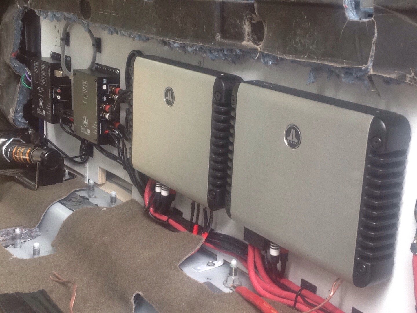

looking for amp install locations and ideas in my 2015 sierra 2500 cc. not enough room behind the rear seats and cant afford to lose any room in the back!
there is a LOT of room behind the back seats. I have line level,2 amps, cap, 2 crossovers, and distribution blocks. Down low there is over 6 maybe 7 inches of space.
DO you have a FULL Bose system? Meaning sub in the center if not there is also tons of room in there.
Guy had 2 JL amps stacked in there and still room for processors.
the digital amps are smaller and need little to no room around them for air. Also still get big power 1000watts.
That’s great! I haven’t taken anything out, but trying to get my handed behind the seats lead me to feel there wasn’t much room back there!
