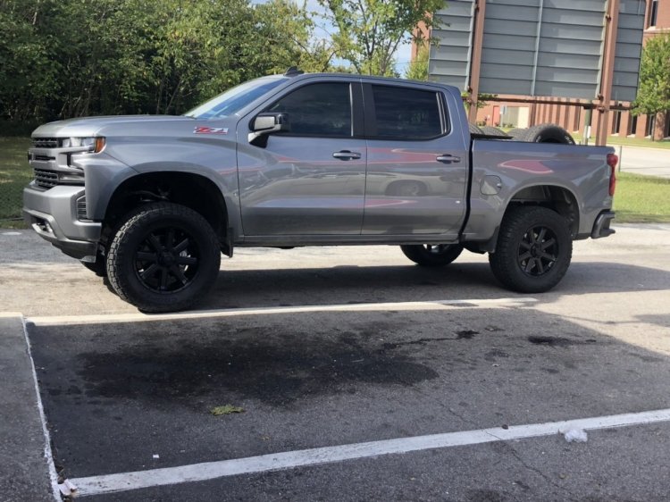

I'll vote again for 2.5". The trucks out here that I've seen with 35s are desert trucks and get beat on pretty hard, I really don't think you will have an issue with 35s on a 2.5" level. Pic for reference

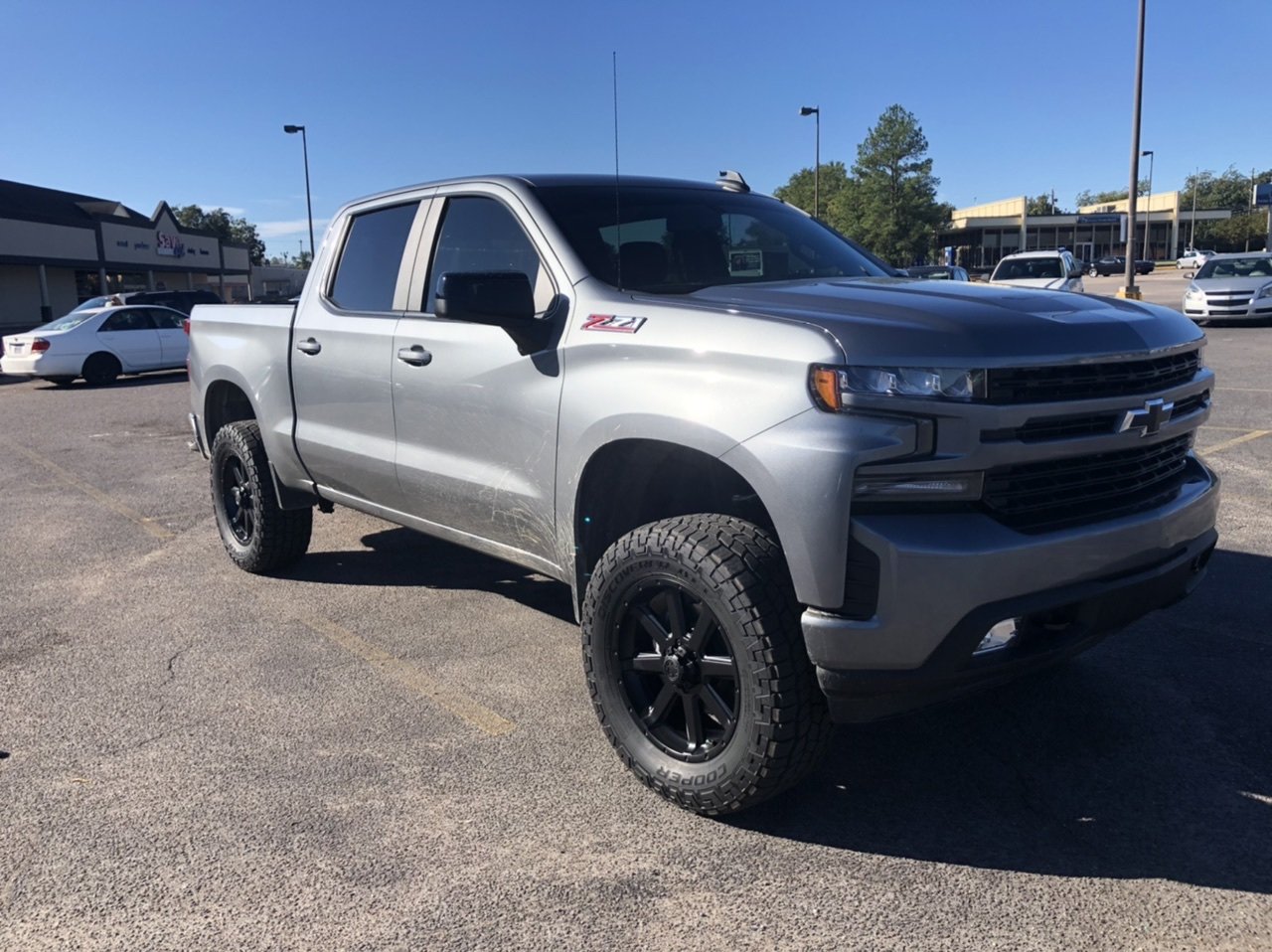

I’m running 2.5  level w 35s and 2” spacers. Req some trimming.

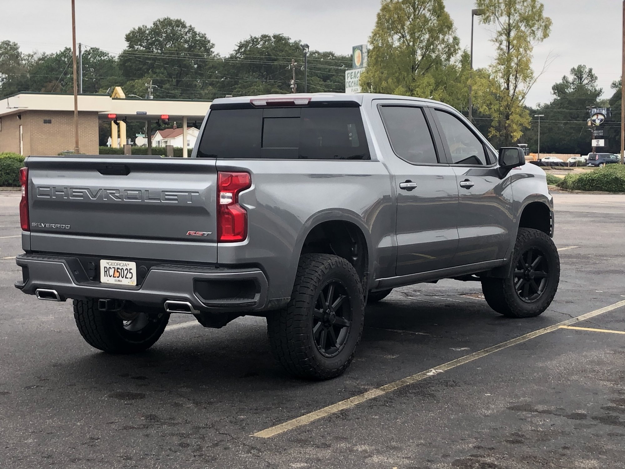

I have the 4 inch zone with 35x12.50x20 cooper AT3s
wheels are 20x9 with +18 offset
zero rubbing, zero trimming
Looks great!
