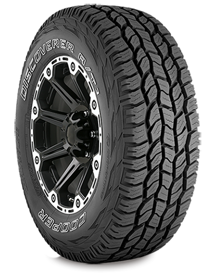

Cooper Discoverer AT3 is my plowing tire of choice. Great snow traction, still good on road. They offer several different variations of that tire, though I have never looked into what they offer for 3/4 ton trucks.
I ran it all year on my last truck, but that one was not my daily driver so I kept the mileage down.
BFGoodrich All Terrain KO2's are severe weather rated and do really well year round. Can't recommend the Cooper AT3; it's the only tire that I've had blow out on me and it happened twice. Could have been coincidence, but I'll never run those again.

The AT3 blew out on the interstate down in AZ. It wasn't super hot out that day. They had probably 4/32 left so i replaced all 4 tires. The second one was actually the RTX version. Not sure what the difference is, but that time it was winter in MN. Both were on the interstate. The most off-road use they had seen would be the occasional gravel road. The RTX was close to needing replacement as well. They both ran well until the blow outs.
